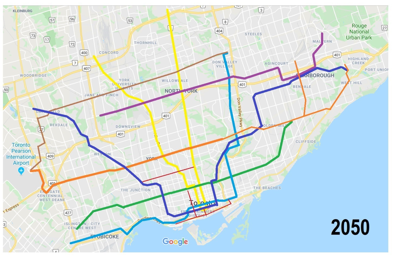

Here is an omelet breaking suggestion. It runs close enough to Yonge to be a real relief. It spaced decently to be express. It goes to Union and other downtown stations. It is building a new tunnel serving new riders
What would be bad about this line?
Nothing - but how urgent is it? I am not a fan of an express Yonge subway - I was just working with the proposal to see if it can be improved.
That said;
  1. The 1st steps in Yonge relief are an extension of the Ontario Line to Finch (Seneca), or even farther.
  2. Next improved frequency on the RH-GO line.
  3. Then its to create a network that doesn't force everyone to transfer at Y-B. This includes; Having Scarborough Rapid transit directly accessing downtown, instead of forcing it onto the B-D Line. Creating multiple transfers from B-D (and Eglinton) to downtown (not just Y-B and St. George). Possible interlining of YUS and B-D to reduce transfers.
  4. When all this is exhausted, a Bathurst Line can be considered (although I have thought of keeping Bay Street open for the Queens Quay East and West LRT's to come up into the core).
That said;
2050? Doug Ford can't think any further into future than June 2, 2022, the next election.
