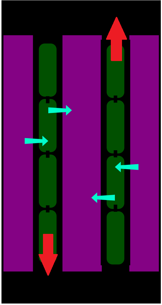

Can you please explain what a Spanish solution is or means exactly. How is it different than normal stations?
A station with a Spanish solution is a station with an island platform strictly for alighting and side platforms for boarding.
Here's a schematic:
Examples of stations with Spanish solution include Five Points station (both levels) in Atlanta and a roughed-in Spanish solution on the Line 4 level of Sheppard-Yonge station in Toronto.
Here's a schematic:
Here's a schematic:
Good diagram.
1) Is side boarding and centre alighting (as shown) more common than the other way around? I can't see either being better than the other.
2) The centre doors open first to allow passengers to exit before opening the doors for the boarding passengers. Have you seen whether some can't make it off and then, like salmon swimming upstream, have to exit through the boarding doors? Is this a problem that actually occurs?
3) Do they typically have controls to ensure that passengers don't board at the wrong platform? Would someone who realized they were going the wrong way have to go all the way around, or could they board from the centre? Hypothetically, could someone head the wrong way (i.e. from a full Davisville station and full trains in am rush) to get on at a Spanish Eglinton station, and by entering from the centre, they could jump the queue on those waiting from the side platform?)

Good diagram.
For a regular station, with trains on two opposite tracks going opposite directions, side boarding / centre alighting is probably the best choice. Each group of riders is waiting on their platform and isn't interfering with the other group. Most of the time, trains do not arrive on both tracks at the same time, thus the people have time to clear the central platform before the opposite-direction train arrives.
But if you have an interchange station, with trains on both tracks going in the same direction, then you might prefer centre boarding so that the riders don't need to guess which train arrives first.
I witnessed the exit doors opening first, but then staying open for as long as the boarding doors are open. Not sure if all systems and all Spanish Solution stations operate like that.
