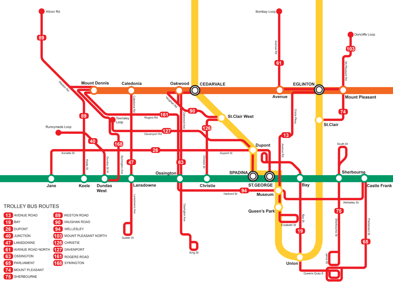

A couple of months back I made a video about what the cities Trolley Bus network could have looked like had we kept and expanded the network. I have made a map version of what was in the video. The new routes are mixture of TTC proposals from back in the day as well as routes I think would have made sense to convert had we gotten the chance. Some routes have since been extended in recent years (eg the 40 Junction), I didn't include those extensions as it's hard to say if they would have happened as a trolley bus. It's unfortunate the trolley buses are gone because they could have played a big role in the TTC and cities effort to go green with electric buses.

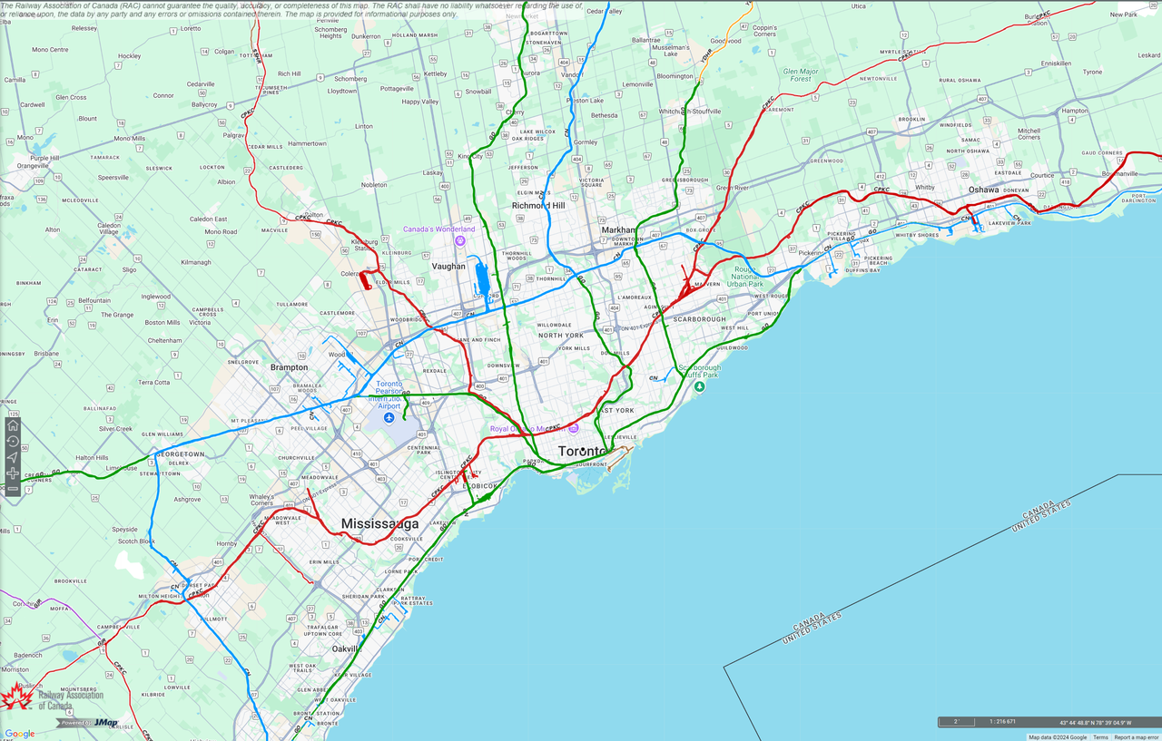

My attempt to reduce "conflict points" between freight and passenger rail in the GTA.
Existing track map of the GTA:

CPKC:
- 413 bypass west of Intermodal terminal in Vaughan
- 407 bypass east of Intermodal terminal, reconnects with existing CPKC mainline north of Pickering
- CPKC trains would still run through Milton GO. Split away from the existing Galt sub before reaching Lisgar.
CN:
- 407 bypass west of Intermodal terminal in Brampton
- Grade separate Doncaster diamond
- triple track Richmond Hill line north of the York sub (increase capacity for both CN & GO)
GO:
- Obtain Milton line
- obtain Midtown line from Lisgar GO to just east of Agincourt Yard
- Obtain Orangeville line. With ownership of the Milton line, GO can now run trains up to Mayfield Rd. in Brampton
- Richmond Hill line improvements, Doncaster Diamond grade separation, triple tracking north of the York sub, construct and redirect trains onto the Leaside Spur
- Obtain Bolton line up to Steeles Ave. North of the 407, triple track up to Bolton for increased capacity for both CPKC and GO.
The only "conflict points" remaining are;
- Trying to figure out how to connect the Midtown line with the LSE line. GO would have to construct a rail bridge parallel with CN's running to Pickering. GO would need to figure out how to triple track to Pickering GO. Not sure if there's space for that without interfering with CN.
- GO would still have to share the tracks with CPKC in Milton GO up until the 407. Unless they can figure out if there's space to run parallel running tracks such as with the LSE line.
- Track sharing with CN on the Richmond Hill line, north of the York sub. Triple track to add capacity
- Track sharing with CPKC on the Bolton line
- North of the 407, triple track up to Bolton to add capacity for both CPKC and GO
EDIT: Add Bolton line info

For the CPKC alignment I wonder if it's possible to use some of the old Beeton sub alignment, its currently a walking trail...
I did measure the distance of using the Leaside/Don branch for the Richmond Hill line and its about 4 miles shorter and possibly could handle speeds 10-15 mph faster than the existing 35 mph route. Triple tracking north of Doncaster should be possible, I run that route with CN and there is definitely space for 3 tracks most of the way to Setter and even space double it most of the way up to Washago if GO wanted to expand north of setter... Though bridge reconstruction would be required for both triple and doubling tracking.
It's too far north and would encounter stiff opposition due to environmental concerns.
The 413 option would be easier, because acquiring land right reside a highway is less contentious. Plus the proposed 413 route heads directly towards CPKC intermodal facility in Vaughan.

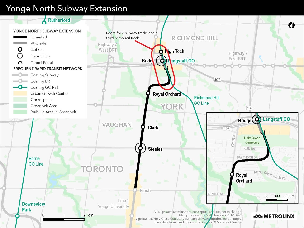

The only issue is the Yonge North subway extension to Langstaff GO. Metrolinx wants to run the subway tracks parallel with the Bala sub and have the trains "at grade" at Langstaff and up to High Tech station. Is there space for a third track plus 2 subway tracks along this stretch of the Bala sub? If Metrolinx opted to tunnel the extension all the way to Richmond Hill, this wouldn't be an issue.
GO doesn't need to go north of Bloomington because Ontario Northland's revived passenger rail will handle that area. Northland will have a new station in Washago.
The thing that would really bring proper frequency on RH into play in my mind would be building a link to the Barrie line north of Bloomington and extending the Richmond Hill trains to Newmarket…. There’s a couple of quite reasonable alignments and I suspect it would do everything subway extensions north of Richmond Hill might be aimed at far cheaper… and probably better.
There doesn't seem to be any way to connect Bloomington to Aurora GO. The Beacon Hall Golf Club is obstructing the most realistic path for such a connection.
The only way to connect the RH line with the Barrie line is to make the connection somewhere north of East Gwillimbury. Have the line run parallel with the 404.
Having YRT create a VIVA BRT line along Major Mackenzie Rd. could connect Maple GO with Richmond Hill GO. Would probably be our best bet for connecting the two lines.
Having YRT create a VIVA BRT line along Major Mackenzie Rd. would connect Maple GO with Richmond Hill GO, would probably be our best bet for connecting the two lines.
Or just expropriate a 10m wide strip of the golf club?
Or if might be sold off to a developer, https://www.yorkregion.com/news/dev...cle_0d67689a-9064-5ba6-9bb6-cc492ef3edf9.html
negotiate with the developer for a 10m wide strip. Maybe with a station on Yonge for direct connections to Viva Blue

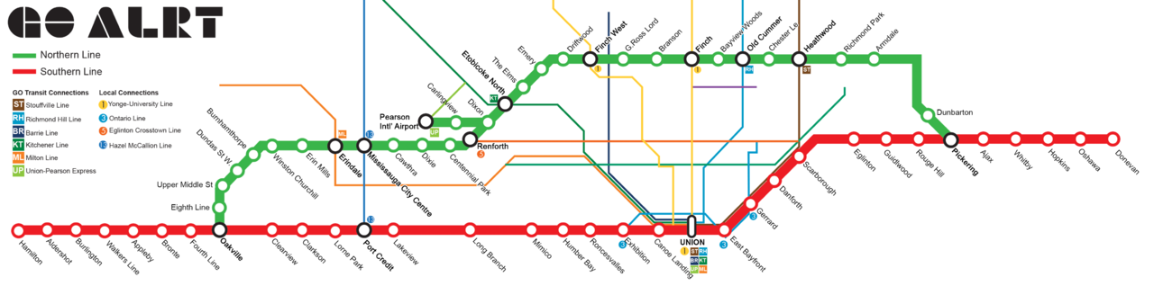

After making my video for GO ALRT I have deiced to make a map of what the possible station for the Northern and Southern Lines could be today. As far as I know the project never made it far enough for station locations to solidify so this is just my best guess for the most likely stops given a 2-3km stop spacing.
Geographic map with some stops given street names for reference.
