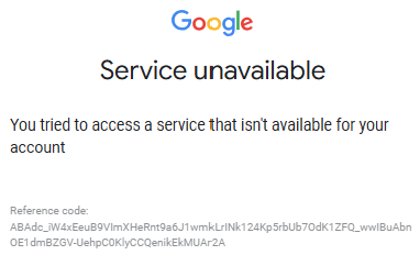

@EnviroTO, instead of a map this appears:
