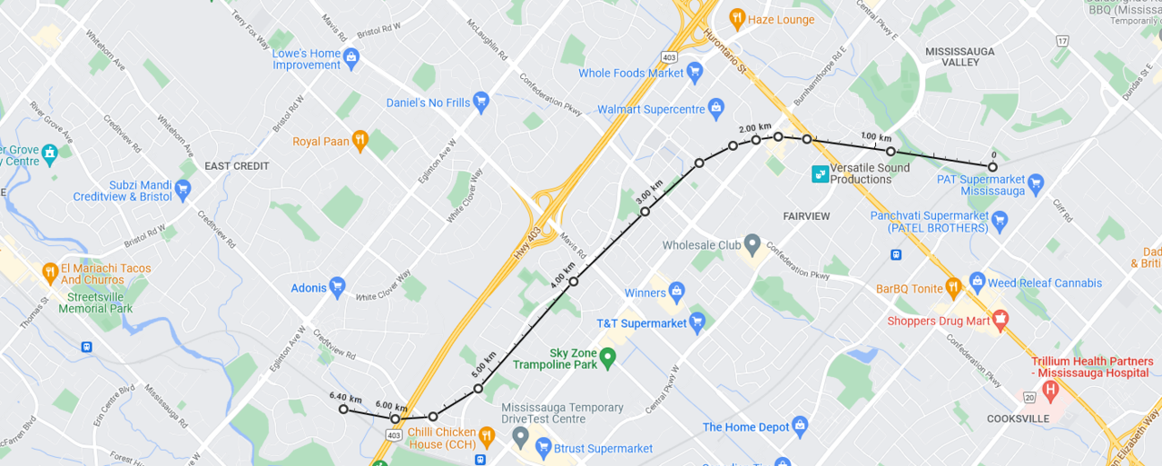

Without advocating for or against, but to contribute here, I mapped out what I believe an MCC tunnel for the Milton GO line would look like in terms of placement and distance.
I would defer to those w/greater expertise than I, in saying I may not have it quite right.
I used only the simple assumptions that:
It must start and end at the existing Milton GO Line (assuming through service)
You want it as straight as possible, with gentle curves.
In the route layout above, I have bypassed Erindale station, one could choose to include that, but it either means a more southerly alignment (right along Burnamthorpe) , or a significant curve to the south at the western extent of the tunnel.

My two cents:
- I don't think it needs to be a tunnel. Roads in Mississauga are wide and an elevated alignment could be used. This would necessitate converting Milton Line to lighter trains, like single level EMUs or even just light metro.
- Burnhamthorpe is particularly wide and was intended for transit to run down it at some point.
That said, I would retain a station at Cooksville, go up Confederation to Burnhamthorpe, and run down Burnhamthorpe to Erindale GO and resume in the Rail ROW. The intersection of Confederation and Burnhamthorpe would be tight with M City. But the station could be on the east side of Confederation south of Burnhamthorpe to maximize the curve radius. If that is too tight, I would suggest departing from the rail ROW east of Hurontario, up to Burnhamthorpe around Robert Speck.

Your suggested route would miss Square One by a good distance. Because of turning radius requirements, it is unlikely the tunnel will go north of Burhamthorpe. Also, it's not a good idea to put a station on a tight curve because you will have huge platform gaps that may need big platform extenders. Or else the station will be place before or after the curve and will be far from Square One in either case.
Northern Light's route has potential to have the station right besides Square One, although his route will go under a lot of homes and that's hard to sell if we go by Yonge subway extension's experience.
