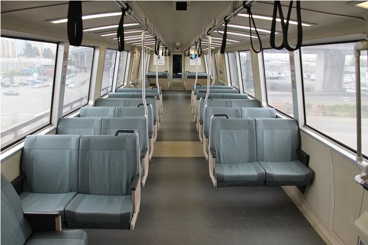

I would prefer to see the subway with GO-style seats, high-back, ergonomic, and padded. I appreciate that very few systems do anything like that, but I think they should. Comfort matters. Its less an issue for an able-bodied rider, for a short-trip.
But I know people in East York who haul out to the airport every day, that's a very long commute for sub-par comfort.
My preferred seats for a subway-type service, BART (Bay Area Rapid Transit in SanFran) probably comes closest
From: https://sf.curbed.com/2017/6/7/15757580/bart-sf-seat-hog-fine

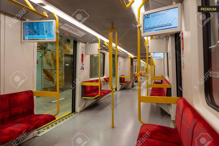

But Warsaw also ranks pretty well, except for going bench-style where I prefer Transverse:
From: https://www.123rf.com/photo_1361362...ors-on-the-first-station-empty-without-p.html
