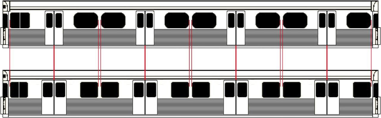

If a 7th car were to be added we could probably kiss PEDs goodbye, since it would totally mess up the door placement, depending on how permanent the 7th car would be (can it be easily removed & inserted, i.e. for peak vs. off peak service), whether or not every single train would have it, and especially if it would be of unequal length compared to the other 6.
Hands down, by far the best case to have PEDs would be if/when the fleet consisted exclusively of T1s and Hawkers, since the really neat thing about them was how both the T1s and Hawkers had EXACTLY the same alignment of the doors (and windows), the doors were perfectly evenly & symmetrically spaced, and the total car length was also exactly the same, as can be seen on the diagram below (also, the trucks were centered exactly underneath the doorways). Of course, the inability to convert both the Hawkers and T1s to ATC would make this a nonstarter. If only subsequent generations of subway cars were designed with the same perfect alignments (which the VAST majority of subways in the world do NOT 🙄 ).
Hands down, by far the best case to have PEDs would be if/when the fleet consisted exclusively of T1s and Hawkers, since the really neat thing about them was how both the T1s and Hawkers had EXACTLY the same alignment of the doors (and windows), the doors were perfectly evenly & symmetrically spaced, and the total car length was also exactly the same, as can be seen on the diagram below. Of course, the inability to convert both the Hawkers and T1s to ATC would make this a nonstarter. If only subsequent generations of subway cars were designed with the same perfect alignments (which the VAST majority of subways in the world do NOT 🙄 ).
Also take into consideration that the cab cars of the TR's are also about 1" longer than the middle cars. 2" in a whole train set isn't much but adding the 7th car will require the train to fit the platform precisely. What about turn back spots and stub tracks? Are the stub tracks at Finch long enough for 7 car trains? They may stick out and block the cross over. Although this is a mute point since the line will be extended.
