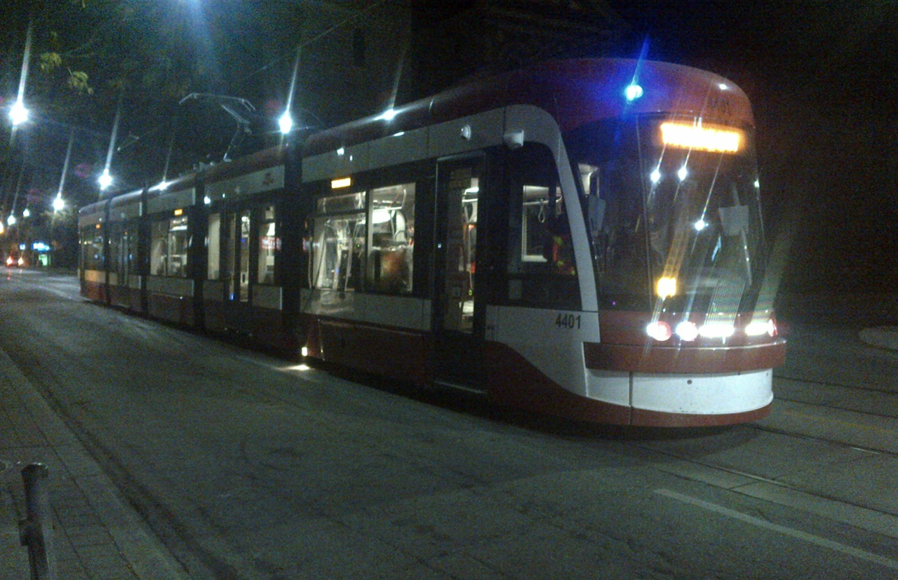

I wish 4401 could at least be used for panto testing and parades.
It's done both, I believe. Here it is with the pantograph up on Queen Street East, westbound, coming off the bridge over the Don.

Hard to tell but that looks like a TTC power line which as I said before is 600v
