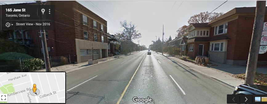

I'm more interested in how you're going to fit a ROW through here:
The road is only 4 lanes and there isn't much in the way of setbacks.

Tbh, I didn't think about the road setbacks when I made the map lol. One solution would be like the Eglinton LRT with an underground portion in areas where surface ROW is not possible. South of Eglinton, the Jane LRT could become underground with fewer stations for example only Eglinton, Alliance, St. Clair/Dundas, Annette, and Jane Station at Bloor. That would probably the best case scenario or else the trains would be in mixed traffic, which would be the cheapest way. As someone who lives/lived close to there, is there a lot of vehicle traffic? If there isn't a whole lot of vehicle traffic, mixed traffic could be a compromise that still allows relatively quick travel.
Traffic isn't that bad (at least at the times of day I drive there) except for a high-traffic intersections. Dundas and St. Clair both have a lot of left-turning traffic and the railway underpass would be a pinch-point for a ROW just like how the Weston road railway bridge is for the St. Clair streetcar.
A tunnel would be good, but it wouldn't have to be all the way from Eglinton to Bloor. Starting from Lambton should be sufficient to avoid most of the expropriation (3.7 km tunnel) or you might be able to keep it on the surface past black creek but by the time you get to Rockclyffe and all the high rises north of Woolner you'd need to be underground to maintain vehicle lanes (2.8 km tunnel).
So for a 23 km transit line you'd have ~3 km underground, not bad. Maybe some targeted grade separations would be planned too.
