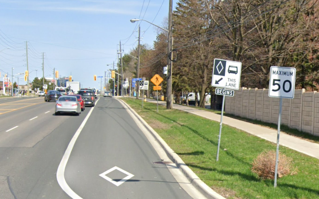

The most infuriating decision that the City has made to prioritize driving over public transit recently has been to build another pair of traffic lanes on Steeles Avenue East between Kennedy and Midland, and not designate those new lanes as bus lanes even though Steeles East is designated as a transit priority corridor in the official plan, and the 53/953 is very frequent and busy (easily meeting warrants for reserved bus lanes).
Steeles Ave in 2019, east of Agincourt Station
Steeles Ave in 2022, east of Agincourt Station
These lanes provide relatively little benefit to through motor traffic since they're usually occupied by stopping buses, and cars turning right, yet if they were designated as bus + right turn lanes they would significantly improve transit speed and reliability by allowing buses to consistently bypass queues at intersections. Note that a single car going straight in the curb lane will prevent any cars from turning right during the red light (e.g. you can't show an eastbound right turn green arrow during the northbound left turn phase).
