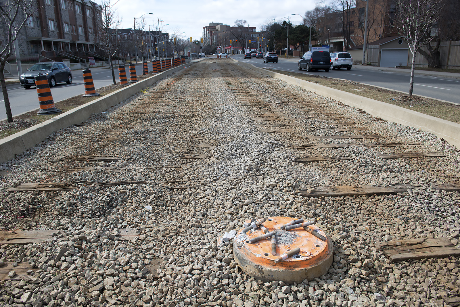

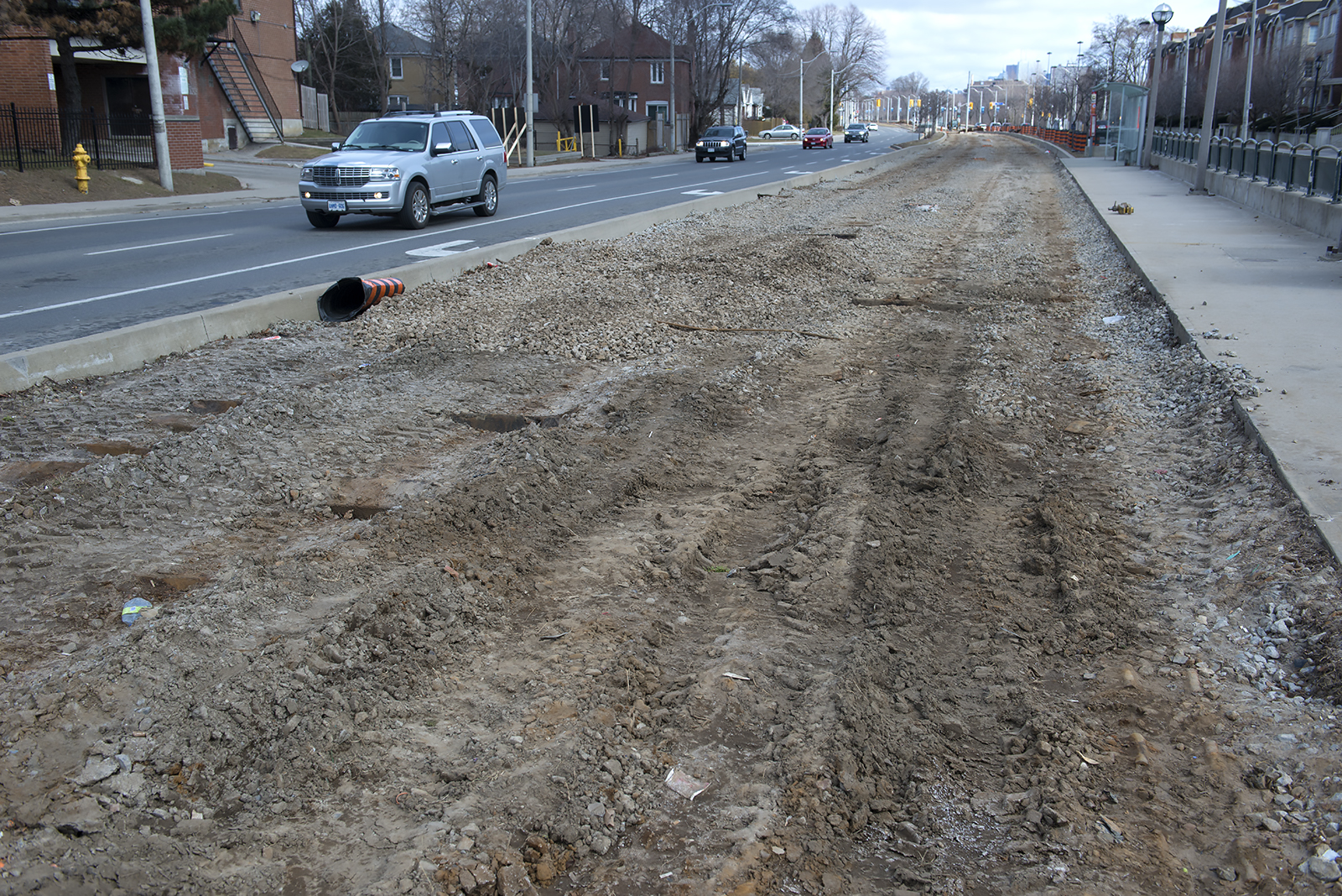

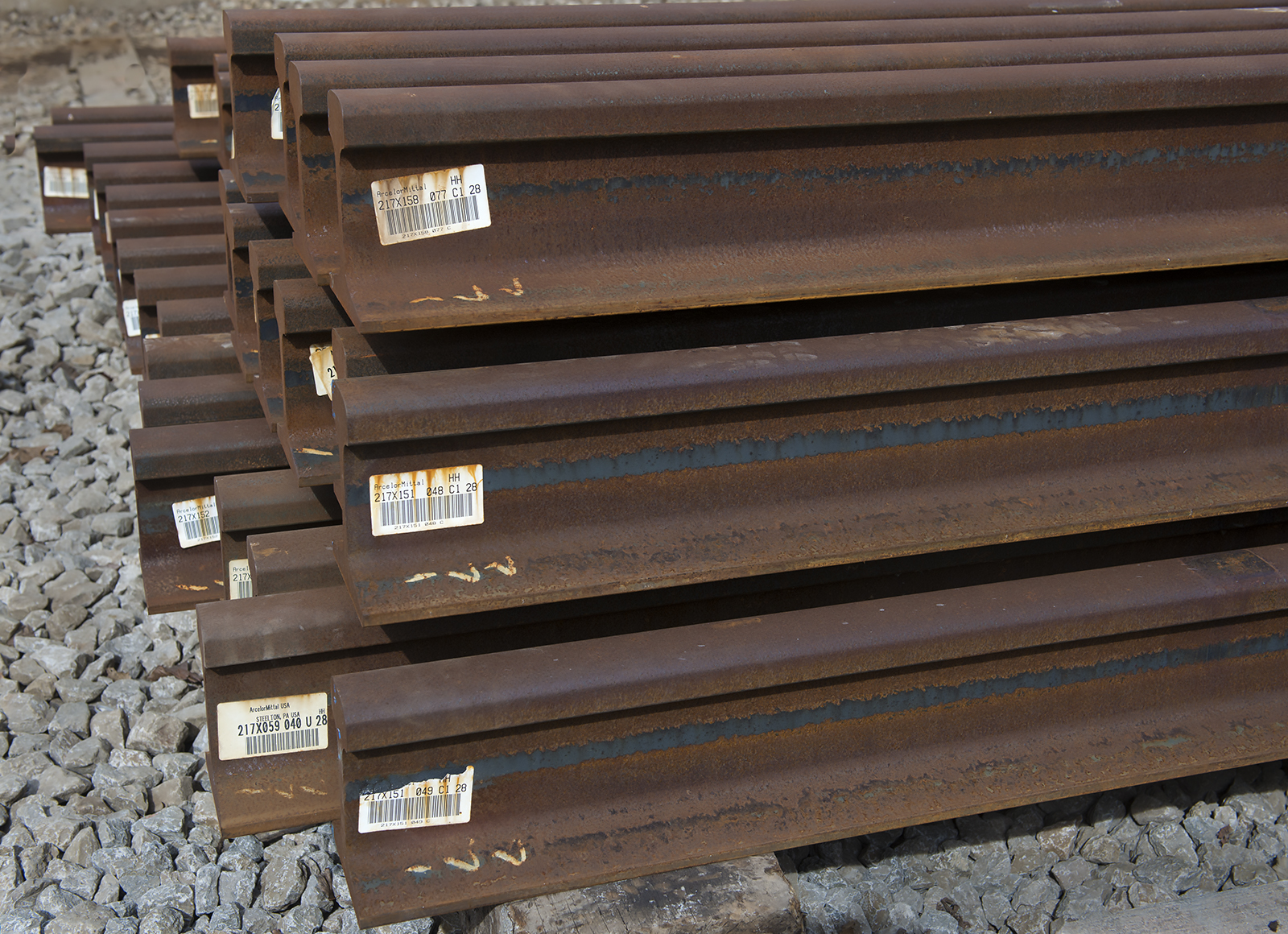

I took a close-up look at the Queensway yesterday. The TTC has started tearing out track, and the contractor for the bridge work is now on site.
The bar-coding on the new rail was curious, as if it was bought at Home Hardware. It's Accellor Mittal rail. The old rail is a mixture of 1993 Sidney and 2003 Mittal rail. I don't know if it will be reused or scrapped.
Clearly TTC intends to scrap the ties, as the old rail was dragged over the ties, scoring them badly. I wonder what the plan is for redoing the ballast. As had been commented in an earlier discussion, the ballast between the ties is good (but dirty) rock ballast, but the subgrade it sits on looks pretty muddy. I wonder how deep TTC will go to improve the subgrade. The center-mounted footing for the catenary poles will be a complication for the backhoe operators when they scrape and grade the subgrade.
Anyways, it's all under way.

TTC will scrap the ties and most likely use new rail. Its possible some existing rail maybe reused, depending on the condition of it and long section if they aren't now.
The new tracks will be built like they have been for the system, since it will be bury in concrete, not like it used to be. It will have the same concrete sub base as rest of the system.
The Queensway, Gardiner Expressway, Lake Shore Blvd. and the railway are all built onto a sandbar that separated Grenadier Pond from Lake Ontario. The pond would have been a bay if it wasn't for the sand bar. Being sand, it is not very stable. That is why the railway (and later the Gardiner Expressway) were built on top of mounds, which adds to the stability. There were other ponds in the area, including a former small pond (since filled in and housing built on) next door to the current St. Joseph Health Care Centre.
Likely it is the sandy base of the sandbar where the streetcar tracks run on are not that stable, and now need better reconstruction.

I believe that they built that section of the line to the older standard of 100lb/yd rail, which isn't really used anywhere else on the system except perhaps in the yards. I can't really think of any locations that TTC has that is big enough to store strings of rail, so I suspect that it will be sold for scrap or reuse.

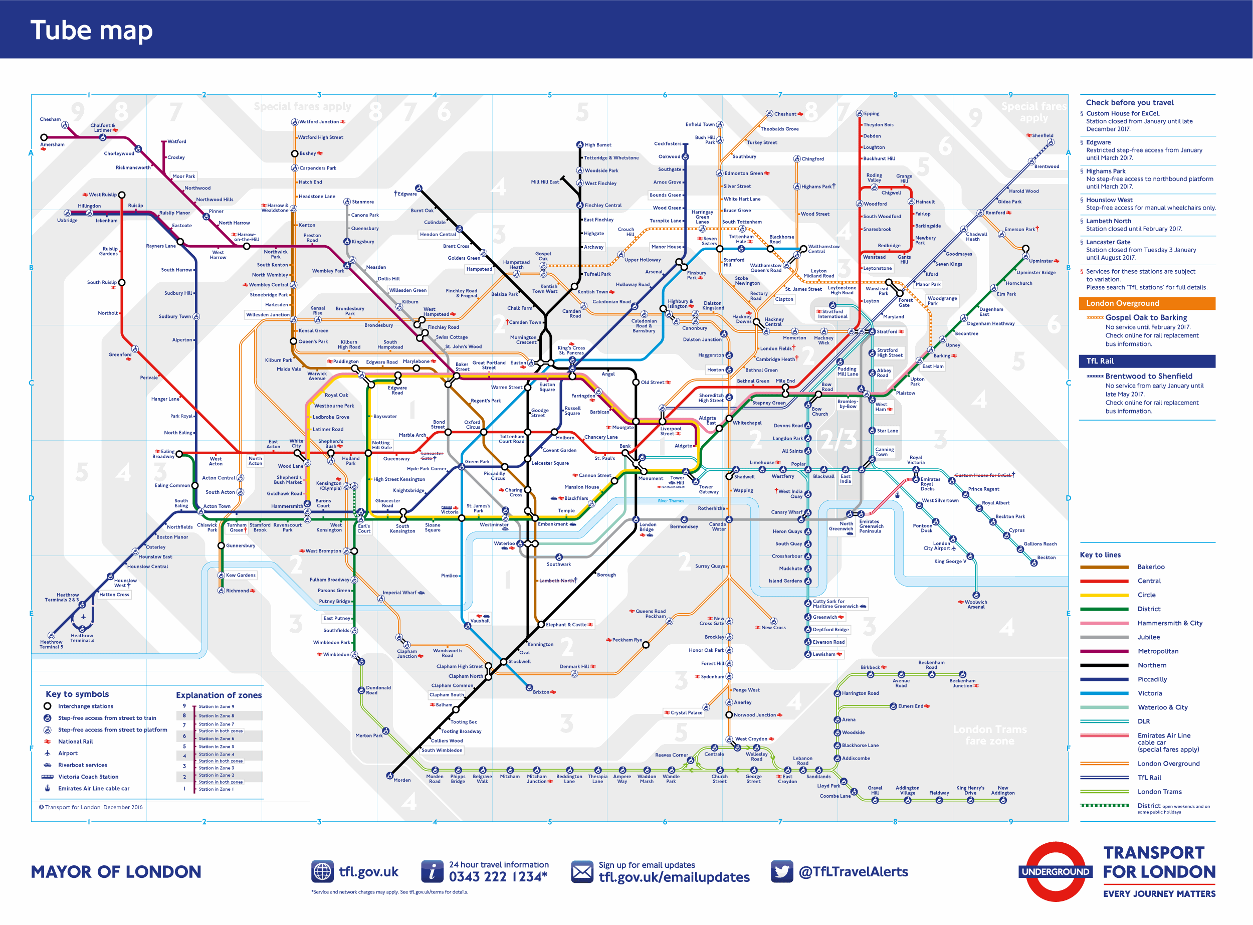

London's new Underground Tube map includes the trams (streetcars).
That map has for years - probably since they opened. That's the "London's rail and Tube services map from https://tfl.gov.uk/maps/track/national-rail - they used to call it something like the National Rail map back in the 1980s.
The standard tube map is this one (and yes, the trams are new here). It also has some of the early Elizabeth line services that have started (Crossrail), which is called TFL Rail since 2015. Also note the expansion of London Overground services since the same time taking over existing National Rail services out of Liverpool Street.

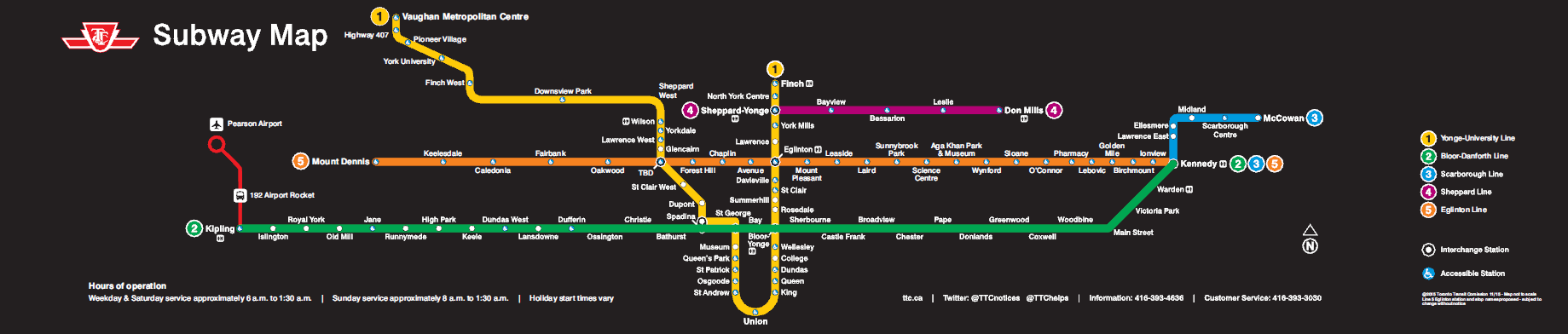

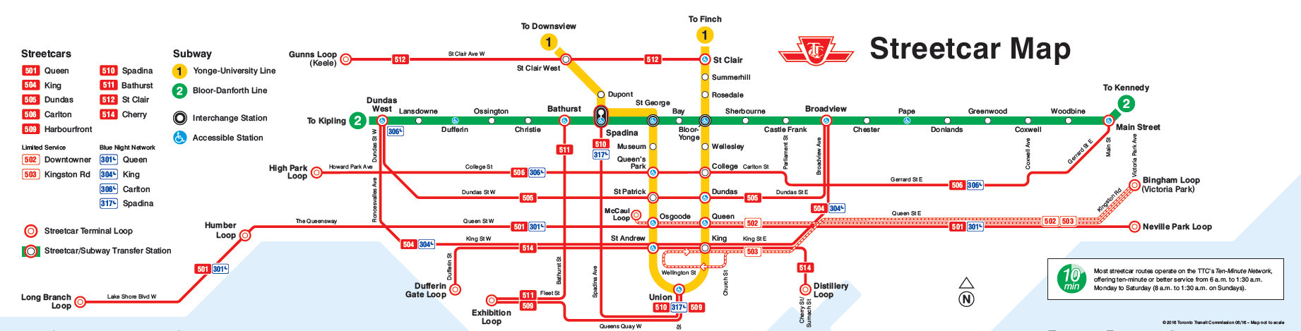

Does the TTC have something similar?
Yes - if you ever get the chance to ride one of the trains, you'll see this (one day):

I am referring to a TTC map athat has the Subways and Streetcar lines all on one map.
