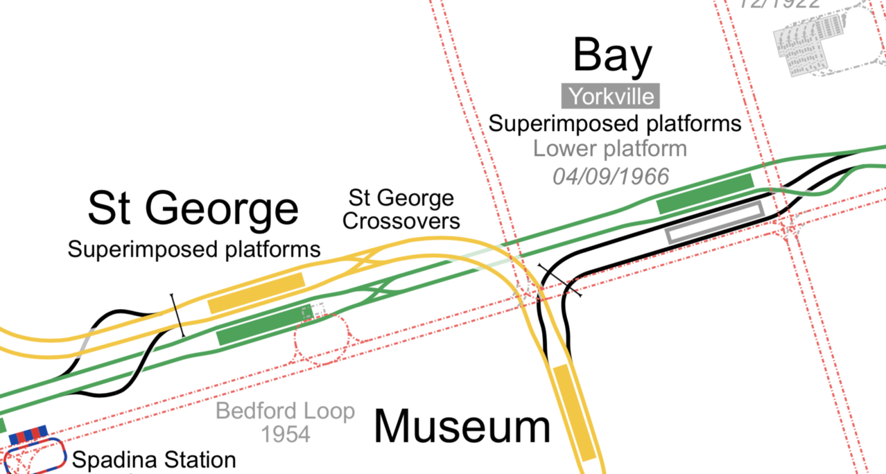

Isn’t the wye grade separated? Which means it was designed so train switching lines to not interfere with opposing trains on the same line?
It is indeed grade separated. I think it's just as mentioned above, any problem at the wye would have a huge effect to the entire system.
It is, but look at how it's designed - St George westbound and Bay eastbound each have 2 platforms. If you are a passenger at either station, and the interlining service is in operation, which platform will be the correct one for the next train? A far better solution would have been for each station to have been built as one level - so that there were only one platform for both eastbound and westbound - or at worst, have only a single westbound platform at St George and a single eastbound platform at Bay.
Instead, they had the system designed more-or-less as the TTC wanted - and which easily allowed the University line to be tied into the Spadina line when the need arose 15 or so years later.
