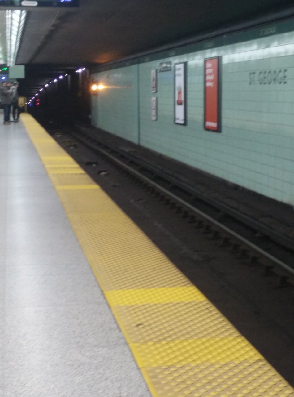

Saw this at St. George, does anyone know what a steady yellow light on ATC signaled track means?

Saw this at St. George, does anyone know what a steady yellow light on ATC signaled track means?View attachment 187445
Looks like a mixed mode operation that allows CBTC and manual trains to run under their own rulesets. A non-CBTC train that follows a CBTC one must follow conventional signals which enforce a minimum separation distance. Could be that the next train was running manually or that there was a localized radio problem.

I agree with the mixed mode ops. There's a track leading to the BD line from St. George and that signal was probably protecting the interlocking. The yellow switched to a flashing green as a line 1 train approached the station.
These are the various signal indications for the new signal system:
Flashing green = clear to proceed through interlocking in ATO or CABS (manual mode with full signalling active)
Solid yellow = clear to proceed through interlocking in MAN (manual mode with degraded signalling) on straight routing
Flashing yellow = clear to proceed through interlocking in MAN on diverging routing
Solid red = stop and stay
Flashing red = Call-on
