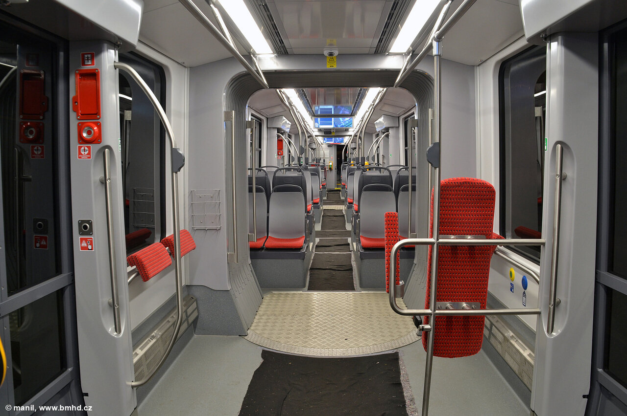

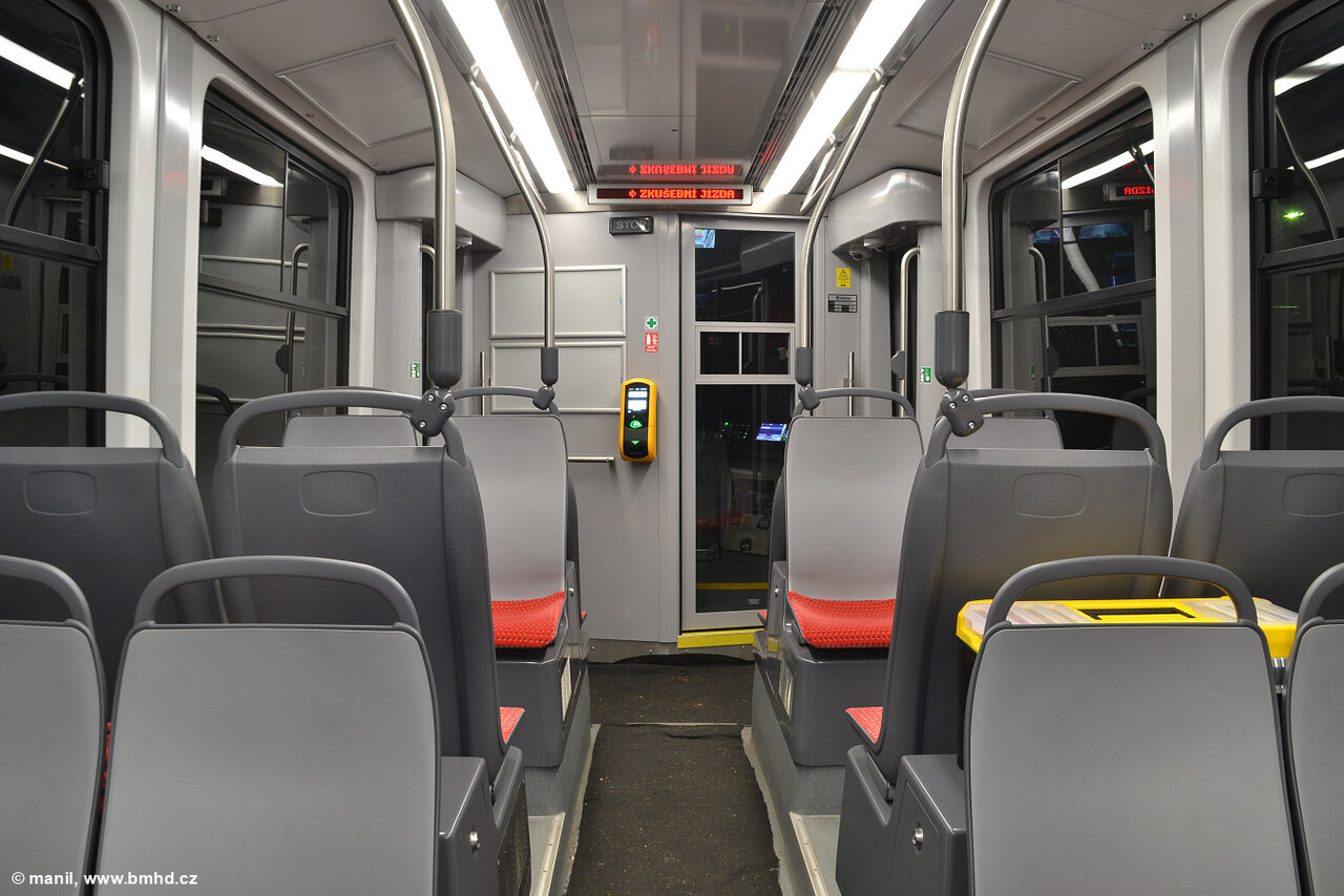

Not a TTC related inquiry, but since there is no catch all tram thread, this will do.
Is there anyone who is able to explain to me how it is possible that low floor trams like the Skoda Artic are able to have fully rotating trucks while still being low floor? I have never ridden one, but interior photos I've been able to find of the 45 T cars in Brno do not seem to show a wildly different configuration than our own Flexitys. What black magic is at play here?
Photo credits to manil from bmhd.cz.
Well, the first problem with your assumption is that they are "fully rotating". They are not - they do have a good amount of rotation, but they are also limited by the various bits of structure in the way to about 10 or 15 or maybe 20 degrees in either direction.
The second is that the minimum radius of the track is also a huge factor in determining what is possible. Toronto's minimum radius is about 36 feet, which is considerably tighter than most European systems - and the ones that do operate on curves that tight usually do so on narrow gauge track. Most of Germany standardized on a minimum 100 foot radius curve, for instance.
So in the Toronto context, when the TTC went asking for options for what became the Flexity cars, Bombardier felt that this design - which they've offered variations on to other systems with similarly tight curves - was the best one suited for here
In the case of Brno, I can't speak to what their system's standards are. I don't know if they have curves as tight as Toronto's. Perhaps they don't, and so the version of the Artic that they received can easily handle their curves.
