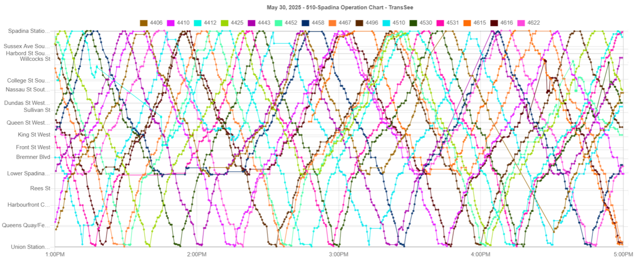

Looking at last Fridays data at https://www.transsee.ca/operatechart?a=ttc&r=510&date=2025-05-30&starttime=13:00&endtime=17:00&ok=OK, I see some 20-minute runs following a gap. But also some 20 minute runs. Though with the bunch that departed Queen at around 3 pm, I could imagine there's be loading delays at Spadina station. Hopefully the construction there to expand the platform will alleviate this. What time were you there?
That work at Spadina is probably the biggest fix, but some cheaper fixes such as removing a couple of stops (Wilcox and Sussex!), improving signal priority (especially after a gap), and make it possible to loop northbound vehicles at Spadina Crescent would help.

A few points worth noting here. If there were excessive delays that removing stops at Sussex and Willcocks would solve, you would see a lot of horizontal lines at those locations, but they aren't there. The big problems come with lack of true priority at the major intersections compounded by the glacial pace streetcars move through special work. Delays at Bremner and at Lake Shore are quite obvious in the chart. I was on a 510 Wednesday at about 10pm, and it ambled all the way from King to Bloor. No congestion, signal delays because it kept falling out of the green wave, and a big gap forming in front of the car. Crowded car because it created its own gap adding to stop service time.
I wouldn't dare disagree with you on the substantive statement....... however...........
There is little question that additional stops add travel time, even if they don't add delays. Acceleration/deceleration, dwell time etc. (clearly shifting riders to the nearest stops adds dwell time, so its not a wholesale reduction of the existing dwell).
I know you lean a bit more towards more frequent stops, for accessibility, and I'm not unsympathetic to that argument, but I would offer that the Willcocks-Habord-Sussex set of stops is 3 stops within 424M. To me, and I think to many, that does read as excessive. We could certainly debate whether to remove one, or two...........or whether to slightly shift platforms.....but I certainly think its fair to consider removing at least one of this sequence and to assume it would at least have marginal benefit on travel time.
I have also argued for reconsidering Sullivan, which taken together with Queen and Dundas is 3 stops in 485m or 4 in 615m in the northbound direction if adding in Richmond.
Removing these stops may not reduce or eliminate gaps, which can be considered a separate, and pressing issue.
But that doesn't mean it would lack value from an operational point of view, with travel time reduction and more positive rider experience.
