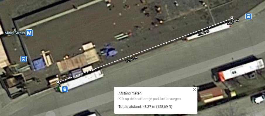

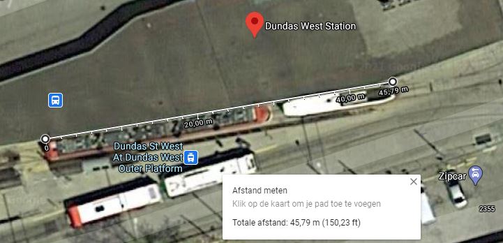

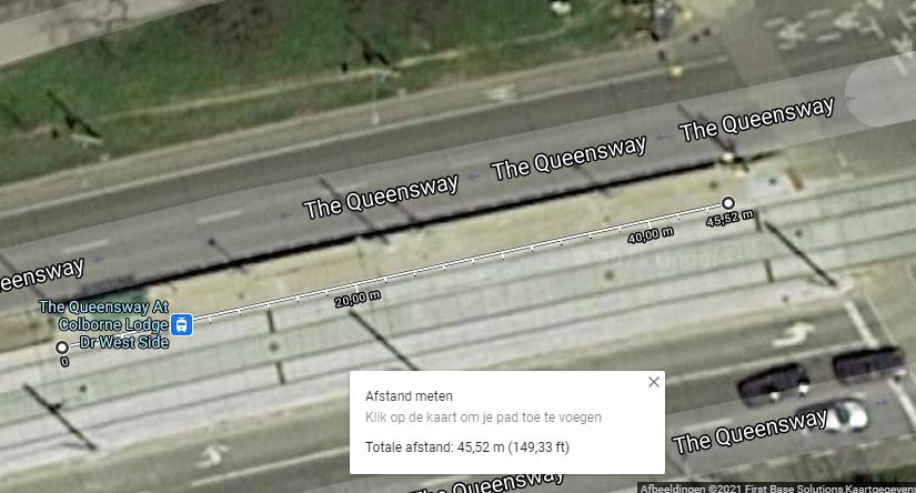

Many major stops built between the 1980's and early 2010's are just over 45 metres long, to accommodate three 15-metre CLRV's or two 22-metre ALRV's.
For example, Main Street:
Dundas West:
Platforms along the Queensway
This has exacerbated the capacity issues at stations such as Dundas West and Broadview where the platform capacity dropped from 3 streetcars to 1 with the introduction of 30-metre LFLRV's. The TTC is working to extend some critical platforms such as Dundas West to just over 60 metres to accommodate two LFLRV's.
It makes sense to get streetcar platforms at stations to 60M wherever practical.
