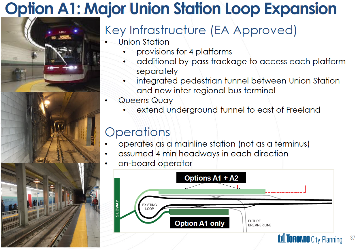

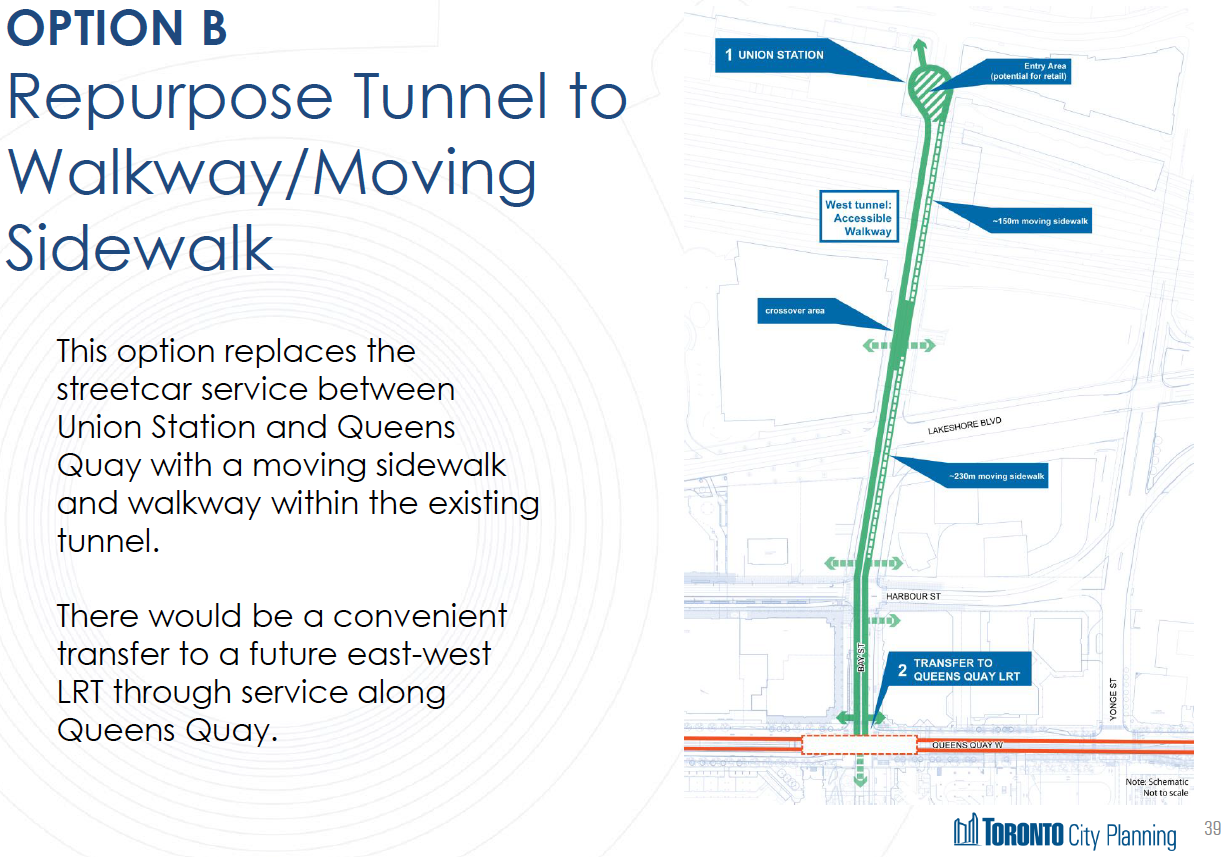

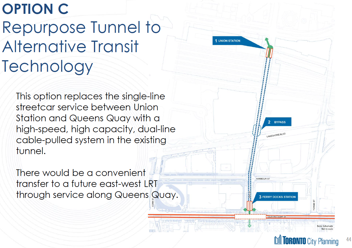

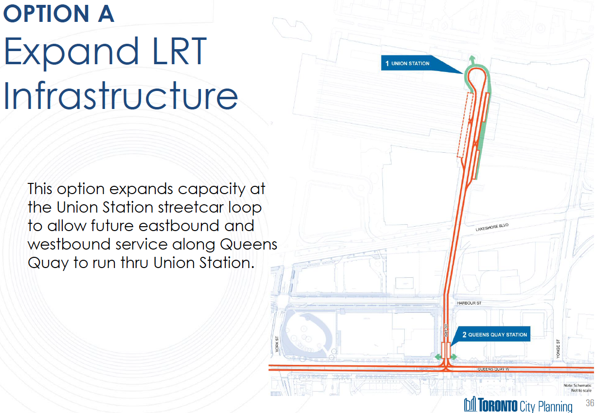

See the Waterfront Transit Reset Public Meeting Presentation at this link. Go to page 33 and onward.

Option B would be great for those wanting to watch the Leafs and/or the Raptors at the Air Canada Centre Scotiabank Arena.
