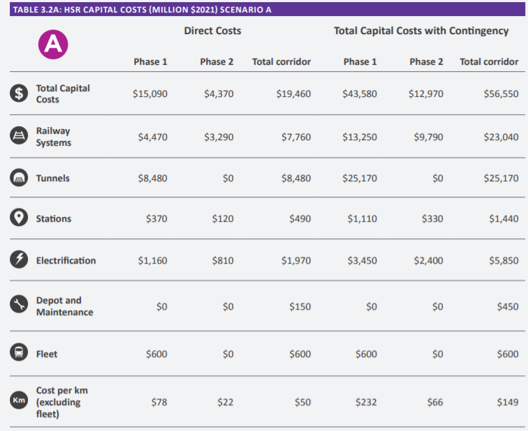

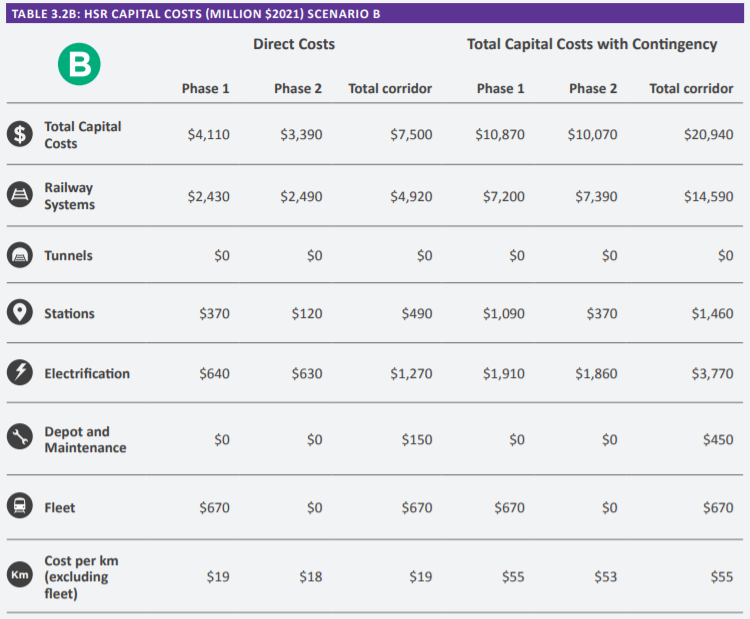

Can someone seriously explain why it costs over DOUBLE just to get 50km/h.?!?!
Bypasses around built up areas; lots of bypasses. The full report went into it in some detail.
seem like the report has been shaped to suit a 250km/h recommendation.
Agreed. There were numerous hybrid options ignored which would allow 300km/h on sections with the same routing as teh 250km/h.
HOWEVER, this is NOT an EA. It's a business case which has the sole purpose of showing an EA is worth funding. That was achieved by showing at least one possible option was worth the price. The EA will consider a lot more combinations of options (briefly, at least).
Why are there so many bypasses necessary? is it required for 50km/m increases in speed?
Seems like this is an apples to oranges comparison. You dont see JR altering the route to fit a N700 vs a Series 0
Can someone seriously explain why it costs over DOUBLE just to get 50km/h.?!?! surely the infrastructure for HSR isnt that much different when speeds are already past 250....it would seem like the report has been shaped to suit a 250km/h recommendation.
You may find a second explanation just below:
http://www.mto.gov.on.ca/english/publications/pdfs/preliminary-business-case-hsr.pdf (pp.50+51)
Obviously. That's the entire point of a business case; show the worst case and the best case to see if funding an EA is worth while doing.
An EA considers each section individually and combines pieces for the best overall solution.
If anything, Metrolinx should hide the business case step from the public except when an EA will not be pursued (show why an EA wasn't funded; not why one is being funded). Far too many in the public get confused about them.
whats the rationale behind tunnelling so much for the 300km/h option? Surely it doesnt require that much more track to slow down an additional 50km/h
There isn't one. The rationale is to show things can get out of hand cost wise if you push too much BUT a profit can be made if done on the cheaper side.
That's all it shows. An EA is worth doing but be careful of a minefield of expensive upgrades that kill the profit.

Here's the full report:
Note, one of those expensive tunnel components is a connection at Pearson Airports new proposed transit oriented terminal; which the airlines are very interested in (international flights make them big money, domestic not so much). That seems likely to occur even in a 250km/h implementation. Bits and pieces from each will be in the recommended solution.
Politicians may/may not follow through on it BUT staff aren't doing anything different than has been done for nearly every other major transit project out there including Ottawa's LRT and Spadina extension which politicians upsized rather than downsizing. You can't judge final political results solely based on the cheapest option in staff reports.
