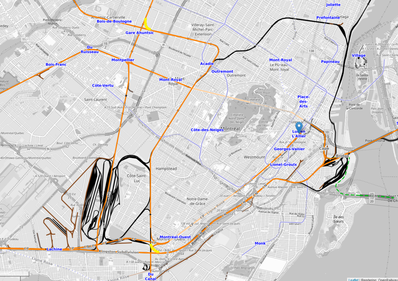

The only way I see a connection happening without people having to transfer on the REM or other, is to back out of Central Station and build two rail connections between CN and the St.Hubert line, and then onto the Mascouche Line from St.Hubert.
Both would require expropriation of land. Yellow for connections.

Assuming we can build the connections this isn't exactly a backing move. There's no reversal except after the station, and we're already getting double ended trains.

Perhaps, it would be easier if the inbound traffic from Quebec City stays on the CN mainline and goes through CN Taschereau yard and goes to the Central Station before going backward to Ottawa-Toronto?
Realistically, this might be what we get. I would be the first to support those new CP-CN yellow connections or the Mont Royal tunnel share between REM-VIA, but I don't see this happening soon. I believe the financial cost would be prohibitive.
Unfortunately, this detour would be costly in time. VIA's trains to Northen Quebec need about 35 minutes from Central - Station to Sauvé which is a bit further North-East of Ahuntsic Station.
^Nitpick - are those yellow connections drawn correctly? I thought the Trois Rivieres line continues straight at Gare Ahuntsic? You have HFR routed towards the CN line to Joliett?
I can’t imagine the lower connection at South Jct (Montreal West) ever happening - too much impact on a neighbourhood.
In addition to the question from crs1026 about using the Joliette line instead of the Trois-Rivieres (which joins at St. Martin's Junction in Laval), isn't the elevation change very significant between the CP line and CN line in Ville-St. Pierre where you show the other connection? I've not checked the elevations, but the slope on the north-south line there is pretty significant already isn't it - essentially you are crossing the western edge of the escarpment? And then there's all those new houses under where you've draw the link.
Personally if I was coming in that way, I'd keep to the CP tracks, and do something cut-and-cover de la Gauchtierre or St. Antoine 4 or 5 blocks to new platforms near Central Station. Wasn't someone tossing that idea around in the 1980s briefly? Much faster travel times than the current disastrous alignment on the CN tracks.
