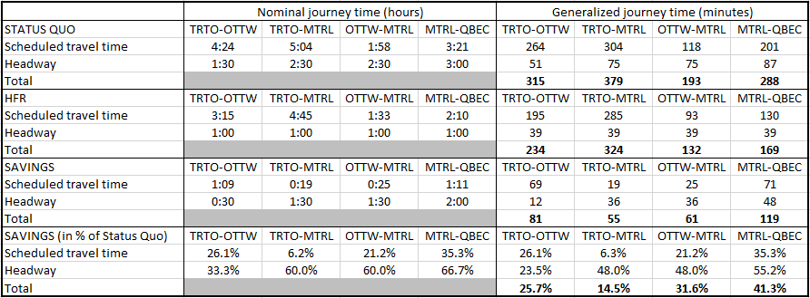

The approximation relied on elasticities and the concept of "Generalized Journey Time" (GJT), using the following methodology:
  1. I divided the Corridor east into its four constituent routes (TRTO-OTTW, TRTO-MTRL, OTTW-MTRL and MTRL-QBEC) and copied the travel times for the status quo and under HFR into a table (shown below as "Table 1"). I calculated the current headways for all four routes by dividing a window of 15 hours (e.g. between 6am and 9pm) by the number of frequencies currently offered and the 15 frequencies assumed in this Globe&Mail article.
  2. I converted the headway figures (Step 1) into a GJT supplement, using figures from the UK's Rail Delivery Group's "Passenger Demand Forecasting Handbook", which assumes that a headway of 60, 90 and 180 minutes adds a travel time penalty of 39, 51 or 87 minutes, respectively, to the perceived travel time (I correspondingly intrapolated a value of 75 minutes for a headway of 2.5 hours).
  3. I calculated the relative effect which HFR would have on the GJT of each of the four routes.

Table 1: Calculation of change in generalized journey time (GJT) for the Corridor East
Compiled from: Globe&Mail article (for travel times and frequencies) and Passenger Demand Forecasting Handbook (for GJT headway values)

All of this just to say that the current trends in population growth give reason to expect a growth in ridership between 2018 and 2030 by 13.3% across the Corridor East (i.e. east of Toronto) and 13.4% across the entire Corridor and that the reductions of travel time and headways give reason to expect a further growth by 37.8% across the Corridor East (ranging from 22.9% on TRTO-MTRL to 65.3% on MTRL-QBEC) and 31.9% across the entire Corridor - for a total ridership growth of 56.2% across the Corridor East (ranging from 38.8% on TRTO-MTRL to 82.6% of MTRL-QBEC) and 45.5% across the entire Corridor.
This means that just looking at three drivers of intercity rail ridership (population growth, travel time, frequency) already seem to explain half of the doubling of ridership you have trouble buying in to. Now, there are a bunch of other drivers which I haven't been able to include in this analysis, but which should increase the demand for HFR further:
