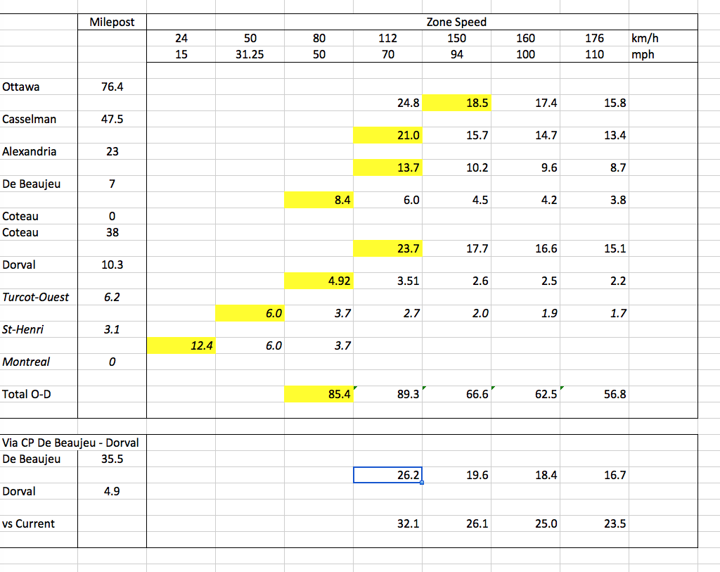

I couldn't resist playing this very helpful point out as a case study. Below are the theoretical trip times, for different speed levels, for the key segments of the Ottawa-Montreal segment. The current typical speeds are the yellow. This is back of envelope so not adjusted for acceleration/deceleration, station dwell, meet times, or contingency. These will not match printed timetables, but if one compares between speeds, they demonstrate the outer bound of what an improvement in track speed in a particular segment will contribute to a faster overall trip.
What one sees is that the approach to Montreal, which is currently limited by track signalling and low speed turnouts, is a huge opportunity to improve trip time. The solution would not necessarily involve new track but would involve new switches and signalling on the existing track. A modest improvement to even 50 km/h speeds would be very constructive, and doesn't demand new civil works or land acquisition.
The second improvement would be to eliminate the diamond at De Beaujeu. Diverting over CP from De Beaujeu to Dorval shaves a couple of miles off the route, but more importantly it eliminates the slow zone between Coteau and De Beaujeau - 50 mph over the De Beaujeu diamond and 30 mph though turnouts at Coteau means trains run below track speeds though this zone. Even if CP only allowed 115-120 km/h, it would save close to 10 minutes. CP may not relent, but I can see why this would score high on the priority scale.
My continuing concern however is that broken down this way, it's far to easy to undervalue incremental time savings. Take, for example the current track from Ottawa to Casselman. It's capable of 150 km/h today. Upgrading to 176 would shave less than three minutes off the route. It's too easy to say that $XM capital for 3 minutes isn't a good investment. But..... At an hourly service, it will be necessary to pass opposing trains every half hour. That imposes a significant time penalty, and it means that trains will be wasting the track's speed capability as they accelerate and decelerate from that meet. If speeds are raised to 176 all the way from Ottawa to Alexandria, westbound trains might be able to clear eastbounds at Ottawa, saving one potential en route meet. So there are savings in the penalty reductions on top of the simple over-the-road time savings.
If I sound obsessed with trip time.... well, I am. I'm very concerned that there are marketability thresholds - if trip times do not improve significantly over auto timings, and again if trip times do not approximate office to office air travel times. I sure hope VIA has the same obsession. "It's only a few minutes more" has been the common factor in too many service downgradings in VIA's history.
I would be a lot happier if the business case was framed as "We need this trip time to be optimally marketable, and here's what it will take to get there" rather than "prove we need to aim higher". A $5B HFR might be a waste, but a $6B HFR might be a huge success. Let's not do this on the cheap.

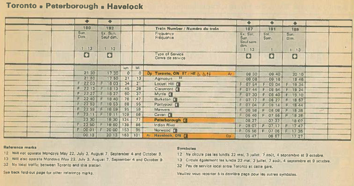

When passenger rail service towards Peterborough and Havelock was terminated in January 1990 (see schedule below), the scheduled travel time between Union Station and Locust Hill was 33 minutes. If we assume that any scheduled stop adds three minutes to a schedule (one for decelerating, one for accelerating and one for station dwell time), then this would be 30 minutes for 34 km distance (when ignoring the stop in Agincourt). Now, if you add your 39 km (67-28 km) detour via Halwest Junction, you would have to achieve an average speed of 146 km/h ([34+39=73] km / 30 minutes * 60 minutes) to match the travel time which was feasible with a lousy RDC 30 years ago. To compare: at that average speed, the travel time required for Montreal-Ottawa-Toronto (580 km with HFR) would shrink to 238 minutes (3:58 hours). And concerning ROW: now that Agincourt Yard is half-abandoned, where exactly do you see space constraints which would prevent the creation of dedicated tracks?
Source: official VIA Rail timetable (effective 1989-04-30)
