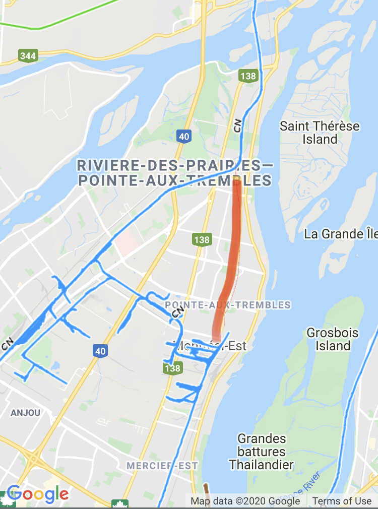

Thinking about HFR service to Quebec, instead of using the Mont Royal tunnel, why not use CN's Longue Pointe spur to access Gare Centrale and or create a parallel tunnel to the original?
Part of the spur has been abandoned. Not sure of the status.

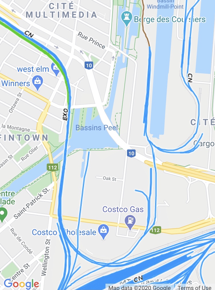

Not to mention that sending anything else than infrequent freight trains travelling at basically walking speed through the highly touristy Old Port area is a non-starter and that it is close to impossible to construct a connection into Gare Centrale:
Most of it is empty and could be repurposed for a new set of tracks. There are a few houses at the very end that would have to be expropriated.
ah shit, it looked like there was already a connection there.
I guess there are a few options then, each one suboptimal

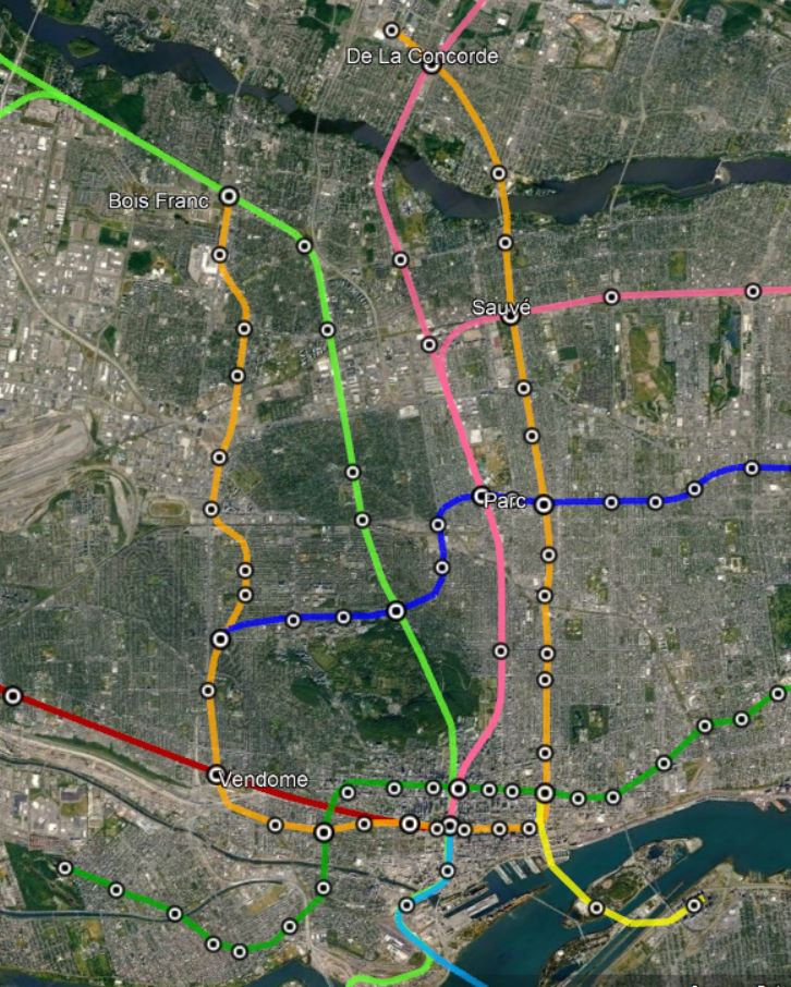

My pipedream a second Deux Montagnes rail tunnel a bit further east, serving the Mascouche line, Saint-Jérome line, VIA Québec intercity, and/or VIA Jonquière/Senneterre services, shown below in pink.
This would resolve the discontinuities currently being introduced to the HFR, Jonquière/Senneterre, and Mascouche services, as well as the pre-existing detour on the Saint-Jérome Line. Plus the commuter rail services would become be a viable alternative to the eastern leg of the Orange Line, providing relief to the metro's most overcrowded segment.
Even in the most optimistic scenarios this would be decades down the road, but it would be a huge improvement to network connectivity, speed, and capacity.
This looks so much nicer of set up especially for EXO lines like the Mascouche and especially the St. Jerome lines.
This would certainly be an endgame fix for the regional rail network if combined with the doubling of the CN line from Anhuntsic to Terrebonne. The designs that I envisioned had included a new direct double track line from Gare Centrale to Gare Parc running parallel to the existing tunnel until past the McTavish reservoir before deviating to the east through a bored tunnel with an exit portal east of the track split near the new UdeM campus. The idea was that this would avoid expensive station construction while leaving underground space free for the future Pink line/Diagonal metro given that this line would be meant for regional and intercity trains. However, watching the McGill station REM construction makes this plan more challenging. They appear to have run into some geotechnical issues and have restarted the collection of core samples on the roads near the station box excavation. Furthermore, there does not seem to be any room to east of the existing station tubes to bore a tunnel at the same track elevation without running into building foundations and the new pedestrian tunnel under Maisonneuve that connects to the green line.

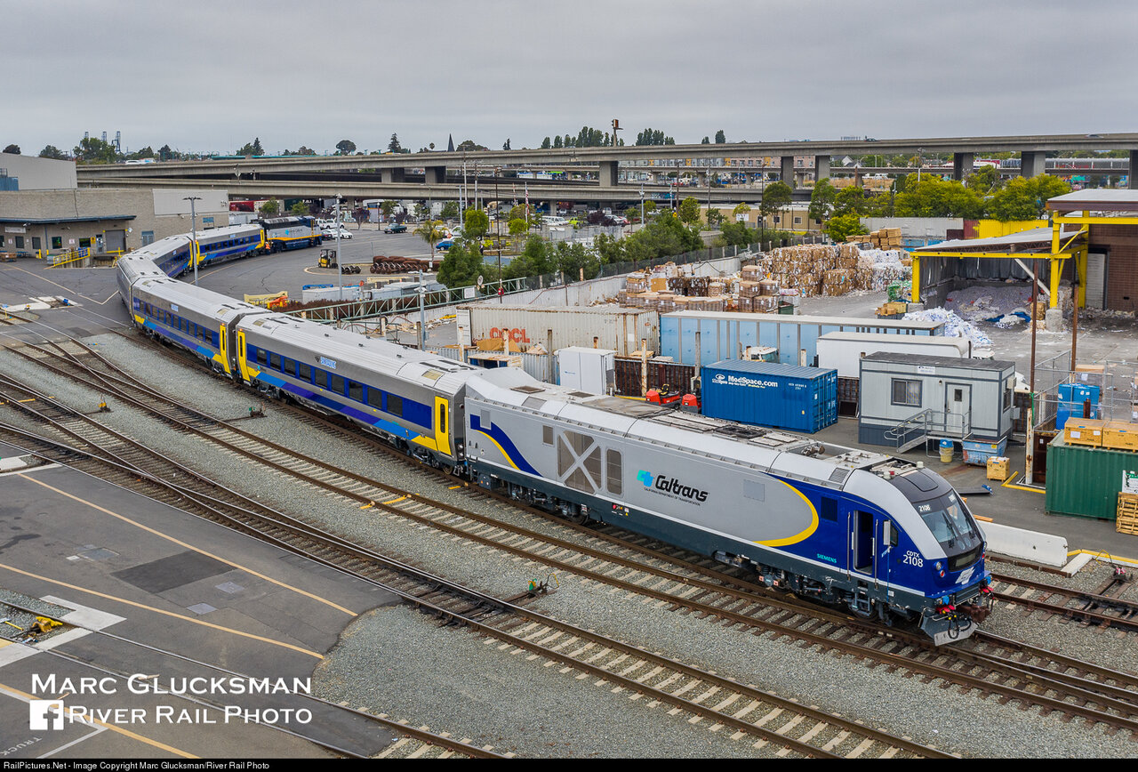

anything new on the new trainset front? Has Siemens started making the first set yet? IIRC they are supposed to begin testing next year.
Honestly looks really nice. Only big operation issue would be using the current trains at an underground Plateau station.
Honestly looks really nice. Only big operation issue would be using the trains at an underground Plateau station.
The station in Plateau is totally optional, it was just an idea to maybe attract some ridership away from the Orange Line from that busy neighbourhood. It can easily be omitted if construction proves to be particularly challenging.
Besides the completion of the Calidot coach order (which will stretch out to about 2023 or so), Siemen's current priority is their 75-unit order for Amtrak ALC-42s. The first dozen or so are currently under construction, with the first one scheduled to be largely completed by the end of the year. Other than a couple of small orders for commuter agencies, VIA's locos should be the next on the line.
They have also recently finalized the design of the cab car and performed some testing on the individual components, and it sounds like the first one of those should be completed - unsure if it will be for VIA or the Calidot order - around the middle of next year.
Just noticed a typo in my original response. I meant to say that the design would be awesome but I don't think that it would be easy to construct and underground station for the current diesel locomotive hauled sets of ten bilevel coaches. A station would be really nice but it runs into the same issues that served as some of the motivations for using metro EMUs for the REM.
