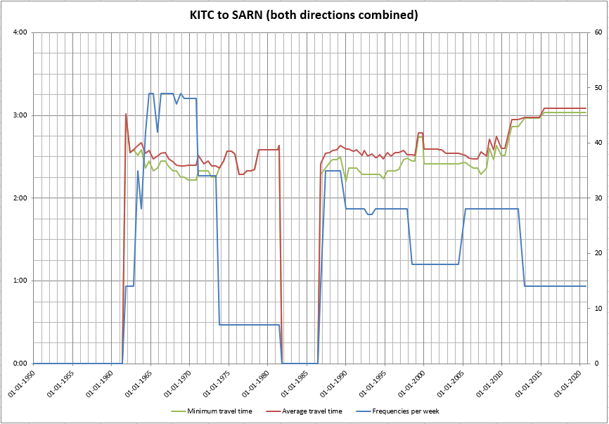

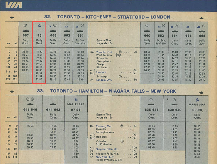

Concerning Toronto-Kitchener-London-Sarnia (TKLS) trains, these trains didn't even exist prior to October 1961 (April 1963 for eastbound services) and again, it was still during the CN years (October 1973) that they were effectively eliminated when CN switched the Kitchener route to RDC service only, leaving only one single westbound TKLS train:
Source: official CN timetable (effective 1973-10-28)

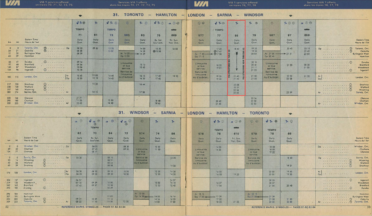

That sole eastbound afternoon train was therefore the only TKLS train which was eliminated during the 1980s (it happened in October 1981):
Source: official VIA Rail timetable (effective 1981-06-01)

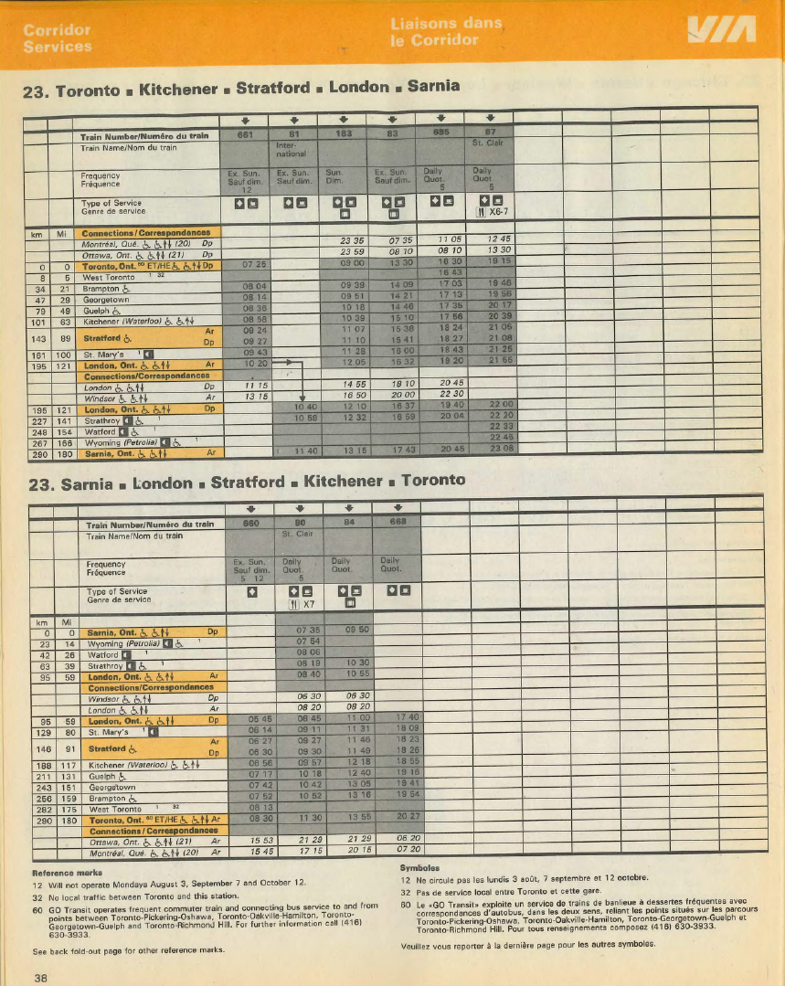

However, TKLS services returned with one single round-trip in October 1986 and were increased to two round-trips (plus a third westbound trip) in June 1987:
Source: official VIA Rail timetable (1987-06-07)
With the cuts of January 1990, the entire Toronto-Sarnia service was reduced to only two round-trips which all operated via Kitchener ever since (except for one of the round-trips which was routed via Brantford Mondays to Fridays between 1998 and 2005). Therefore, I really don't see what makes you believe that VIA would neglect the connection between Sarnia and Kitchener:
Compiled from: official CN and VIA Rail timetables
