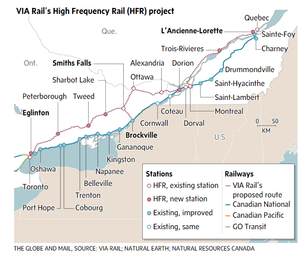

I continue to ask, if CN and VIA have agreements that will enable HFR east of Coteau, what stands in the way of reaching solutions that could be applied west of there, given assurance that VIA will absorb capital investment?
I can't comment on the exact route VIA intends to chose for HFR, but this is the most recent map I recall seeing published anywhere:
Source: Globe and Mail (June 24, 2019)
Almost all grade separations are taxpayer-funded.
I never claimed the contrary, I just said that I don't see an economic case for the taxpayer to fund grade-separations on the Kingston Subdivision.
