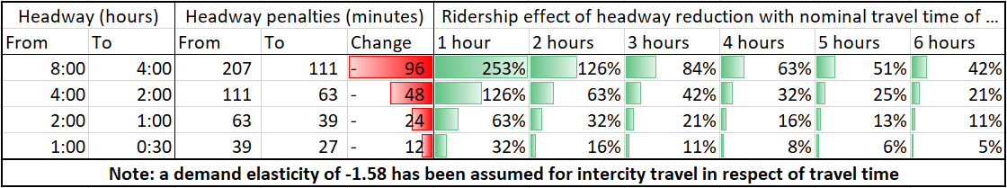

See @Urban Sky 's post. It's what he explains about how travel time is perceived by travelers in regards to headways.
Let's take a scenario where service is hourly on the hour. I finish my meeting at 430pm. I can catch the 5pm train out. My wait time is only 30 min. In reality most of that might be spent getting to the station and pre-boarding. Now, let's say the service is bi-hourly and I missed the 4pm train. I will perceive a whole hour as wasted, while waiting for the 6pm train. This is particularly relevant if we're talking about a distance that can be driven in 3 hrs or flown in 45 mins.
Indeed, passengers look at the difference between the time they have to leave home and the time they need to arrive at their destination (or for the returning leg of a round-trip: between the time they want to leave the destination and the time they arrive back home) and place a similar (negative) value on involuntary waiting time at the destination as they place on the nominal travel time itself...
