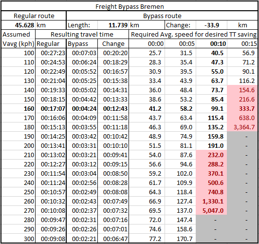

To explain this, let's look at an actual real-world example of the Bremen Freight Bypass:
Basically, an 11.7 km long bypass (from Sagehorn to Bremen-Gabelung) avoids a 45.6 km long trip through Bremen (Germany's 11th-largest city and smallest city-State with just over 500k people), thus shaving 33.9 km off the route or 2.9 km for every km bypass built:
Adapted from: DB Netz Register of Inftastructure

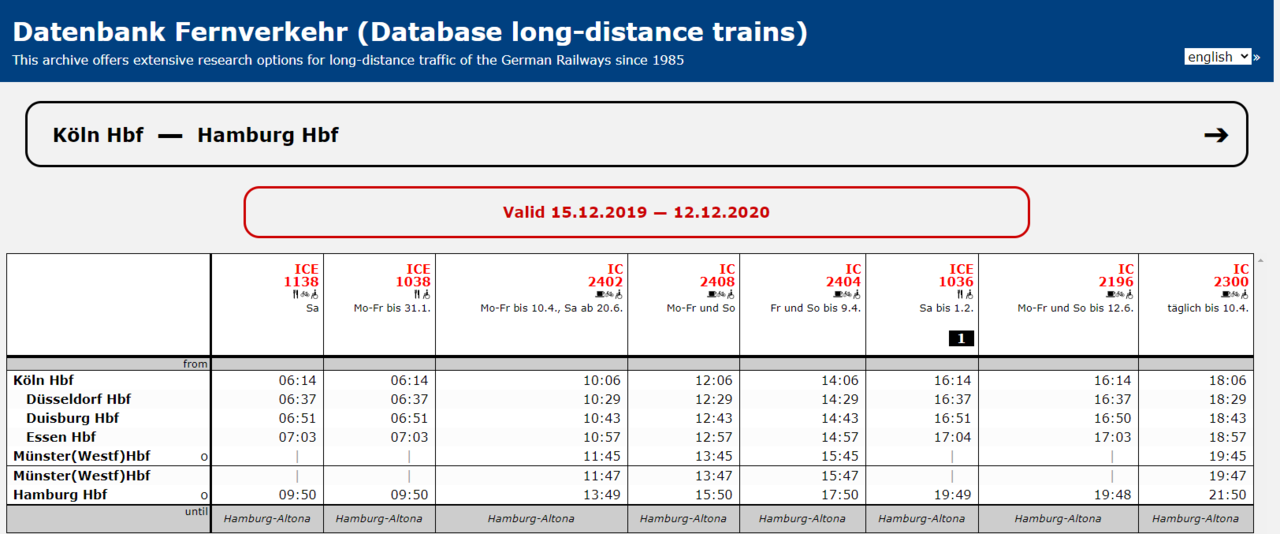

Note that out of 21 intercity (IC/EC/ICE) trains running daily between Cologne and Hamburg, only 6 make use of this bypass, whereas 15 trains (i.e. one per hour) use the regular (longer) line to serve Bremen Central Station:
Source: Fernbahn.de
Consequently, the Bypass line is unlikely to be upgraded beyond its current speed limit of 100 km/h (even though the regular line is capable of 120-200 km/h), as even at an assumed average speed of 160 km/h on the regular line (a unrealistically high estimate!), an average speed of 100 km/h on the bypass route would save exactly 10 minutes, whereas even an upgrade to 300 km/h (the fastest speed of any train reached in Germany while in revenue service) would fail to save another 5 minutes):
Note: speed figures highlighted in red means that the average speed required to achieve the desired travel time saving exceeds the average speed assumed for the regular route.

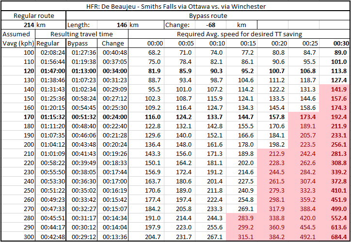

Now, let's look at the Ottawa bypass and assume an average speed of 120 km/h (i.e. roughly the average speed implied by the latest travel times we've seen for HFR) for the segment you want to bypass (i.e. De Beaujeu to Smiths Falls): This time, the regular route is 214 km and the bypass route is 146 km, meaning that the bypass would save 68 km or about 450 meter for every kilometer of Bypass built. Note that the bypass is 12 times longer than the Bremen Freight Bypass, but shaves only twice as much of distance off the route. Note also that upgrading the Winchester subdivision to HFR standards means building new tracks and passing loops, whereas the existing route via Ottawa is already mostly straight and requires very minor upgrades for HFR. Anyways, let's still assume we would build that bypass and chose an average speed so that it saved 30 minutes of travel time (i.e. at 113.8 km/h, see table below), every subsequent upgrade on the Ottawa route would reduce that travel time advantage and would eventually make the whole bypass redundant once the average speed on the "regular route" exceeds 160 km/h (i.e. an increase of only one-third compared to HFR speeds).
Note: as in the last table, the speed figures highlighted in red means that the average speed required to achieve the desired travel time saving exceeds the average speed assumed for the regular route.
In the end, the fact that the incremental costs to upgrade an alignment raise exponentially with the design speed, it is clear that the bypass would never be upgraded to HSR standards and that's the point where even you should realize that it would be a costly mistake to ever build it...

Interesting analysis, even if it is a strawman argument. You said, "for the segment you want to bypass (i.e. De Beaujeu to Smiths Falls)" yet I never said anything about De Beaujeu. In fact, I said:
While using the Winchester Sub would technically be an option, I don't think it is a very likely one given that I don't think CP would be willing to have their network disconnected from the Atlantic ports.
If I wasn't suggesting the use of the Winchester sub, I am not quite sure what other bypass route you had in mind that would extend all the way to De Beaujeu. One of the other problems with using the Winchester sub form De Beaujeu as a bypass, is it runs parallel and within 7.5 km to VIA's own Alexandria Sub for almost 50 km. It seems kind of a waste to me. Better to have trains to/from Ottawa use the same track as the Toronto-Montreal trains whenever feasible.

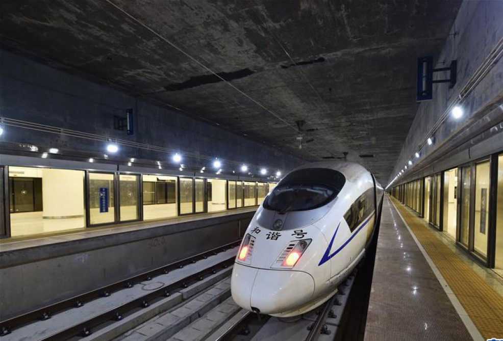

I see no realistic scenarios where a new tunnel is constructed. It would need to be a fantastically expensive new bore that may not even be possible given the existing building foundations. The existing tunnel was already widened to its maximum possible extent without encroaching on building foundations in order to fit the platforms of the McGill REM station. Furthermore, widening a metro/subway tunnel to accommodate heavy rail running non-stop along the route and bypassing multiple stations would be akin to a total rebuild and be correspondingly disruptive.
Which is why I tried multiple times to create a separate thread to have one for what can happen (i.e. this thread) and then one for what should happen (which could be called “fantasy rail discussions”), as the two discussions are based on completely different assumptions and environments
Yes. Seriously, who actually believes that VIA got all its top people in a room and said "dream big, what should we do", and ideas like HSR point-to-point were discussed but ruled and as not being good enough or bold enough and the ultimate winner in the conversation was diesel service through Tweed?? It is clearly a solution to accept a totally different version of reality to a solution where HSR is in the picture at all, let alone a mix of HSR direct Toronto-Montreal by-passing everything, plus HSR in Peterborough, plus HSR in Ottawa, plus HSR in Kingston.
You may have missed it, but back in post #8,710 I made the following post, so a new or wider tunnel is not necessary:
