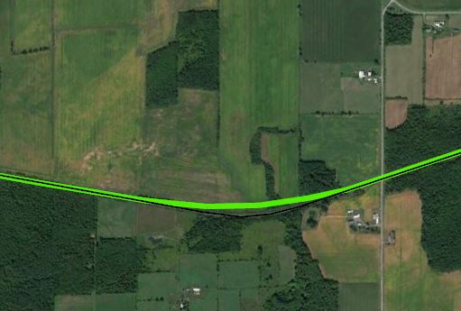

Along the Smiths Falls subdivision there is an 85 mph (137 km/h) speed restriction due to a curve right in the middle of an otherwise 100 mph (161 km/h) segment.
Existing speed limits in mph
Since the curve is only a few degrees, relatively little property would be required to widen the curve radius to allow trains to maintain a steady 110 mph (177 km/h).
Black line: current alignment; Green line: new alignment

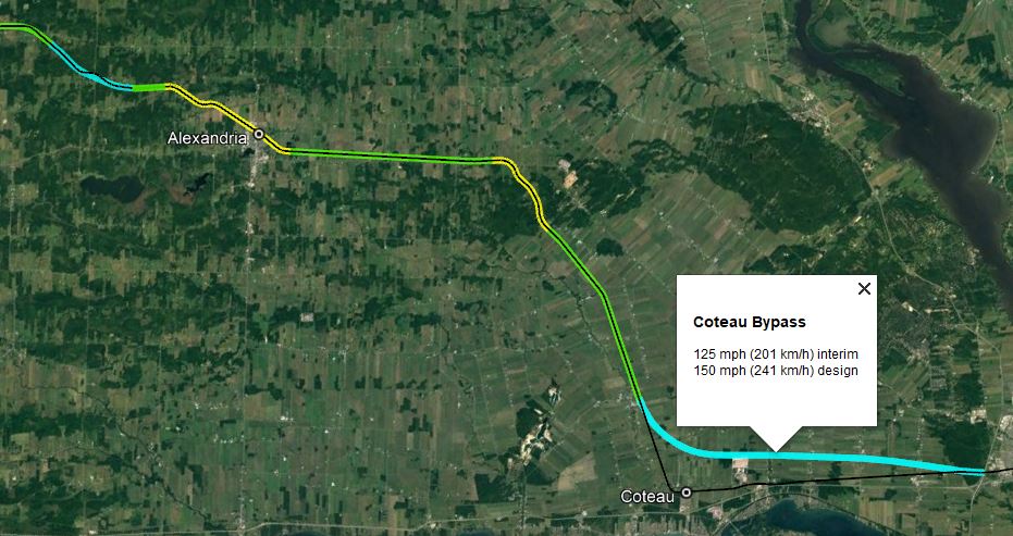

Along the Alexandria subdivision there is a collection of 3 sharp curves in a segment which is otherwise quite straight. Together, these 3 major curve realignments, as well as three more slight realignments, would create a 26 km (16 mile) segment of continuous 110 mph running at quite a modest cost.

Actually, now that I think of it, the rail-to-rail grade separation might even be included in the $491M as a negotiating chip with CP.
New ROWs in blue
