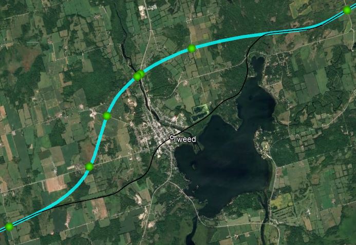

Given this discussion of 200 km/h running, here's where I can see that happening based on my non-scientific look at the existing Havelock ROW in Google Earth:
Existing 200km/h-plausible segment
There is a 16 km (10 mile) stretch of the existing ROW just east of Tweed which could be plausibly upgraded to 125 mph (200 km/h), marked in blue on the image below. The existing Havelock ROW generally has lots of sharp curves in this area because they made only the bare minimum investment to overcome geographic obstacles, but this particular segment has quite gentle curvature because it is following a ridgeline which itself is curving very gently. There are two sharp S-bends which would need to be bypassed, but that's less than a kilometre of realignment in total.
Due to the remote location, this segment only includes two road crossings (both of Sulfide Road).
This little 200 km/h zone would bring no significant travel time benefit on its own, but there also seems to be a case for new 200+ km/h lines on both sides of it.
Tweed Bypass

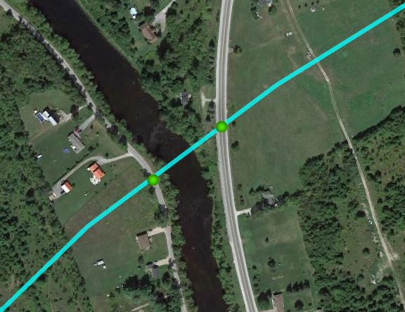

Immediately to the west of this segment is the town of Tweed, which is a significant political and logistical obstacle to the alignment. The existing ROW makes a sharp curve through the middle of town and crosses numerous streets at odd angles. Trains would need to slow to a crawl, and even then they would still be extremely annoying to the town residents, who would certainly demand a station as compensation. Instead, an 8 km (5 mi) bypass could be built through relatively easy terrain north and west of the town.
This segment would need a bridge over the Moira River, and I figure we might as well build it high enough to grade separate the two adjacent roads while we're at it.
Combined with the possible 200 km/h zone along the existing ROW, this bypass would produce a 26 km (16 mi) 200 km/h zone if all 7 crossings are grade-separated, or a 22 km ( 14 mi) zone if the line is only the 4 easternmost crossings are grade separated (including the two Sulfide Road crossings along the existing ROW). In both scenarios, one of the crossings is a minor road which could alternatively be closed rather than grade-separated.

East of that existing 200km/h-plausible segment is the notoriously squiggly segment which includes ploughing through the centre of the town of Sharbot Lake. As a few others here have suggested, there may be an opportunity to build a new bypass railway north of Highway 7. Since the ridgelines in this area have very gentle curvature and are running parallel to the route, the new railway line would rarely need to cross them. So there is a chance that a new high speed line here could be relatively affordable despite the rocky terrain.
If the bypass rejoins the existing ROW east of Sharbot Lake, the length of new ROW required would be 49 km (30 mi). Combined with the possible 200 km/h zone along the existing ROW and the Tweed Bypass, there would be 75 km (47 mi) of continuous 200 km/h running.
Blue: >=200 km/h
Green: 145-180 km/h
Yellow: 105-130 km/h
Orange: 65-100 km/h

This segment is extremely remote. There is barely any human habitation of any sort, let alone closely-spaced buildings. The only places where the alignment traverses inhabited areas is on the outskirts of Tweed and Sharbot Lake where buildings are spaced quite far apart and there would not be any setback issues. Indeed this is a point in favour of building bypasses around those towns because the existing ROW does pass uncomfortably close to existing buildings.
There's a lot of farmland around Tweed that could generate the same kind of opposition to a by-pass that the HSR proposal to London did. That's not to say it's a bad idea though. The area from there to Sharbot Lake seems the easiest place to build a new right of way and increase speeds.
