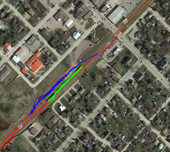

At Glencoe, 76 often has to double stop because the passing siding ends just south of the station platform and 73 is constantly delayed. By the time 76 arrives in London, it's often 20 minutes late. Since it missed its slot, it's put behind a slow-moving freight train from Sarnia until Woodstock adding another 10-minute delay. By the time it gets to Aldershot it's 30 minutes late and has to wait for a GO Train to pull into the station. Since it missed its slot, 76 gets put behind another GO train until it reaches the quad-track section of the Oakville-sub where it arrives at Union Station 40-minutes late chronically. Train 76 then turns into 48. If 76 is delayed enough, 48 to Ottawa gets delayed as well.
If Glencoe was twin-tracked, it could easily save 5 minutes and reduce the possibility of downstream delays.
To sum things up, seemingly short delays in one part of the network can easily cascade into much larger delays downstream. Thus, you must look at the big picture when making decisions regarding network improvements.
Below is a satellite image of Glencoe station and the surrounding area.
Red = Existing Track
Green = Existing Platform
Blue = Siding Extension
View attachment 337518View attachment 337519

Agreed, but as your analysis shows, the delays of 73 (and its cascading effects on 76 and 48) have little to nothing to do with the track quality of the VIA-owned segment of the Chatham Sub...

The analysis above of the Glencoe siding situation is good, although complicated if we want both trains to make a station stop. Starting from the principle that investments should be designed to make CN dispatchers happy by improving freight fluidity and keeping VIA trains on-time and in their slots is a good way to keep passengers happy. In my experience, 73 is also often held out on the Strathroy Sub main track at Komoka awaiting 76, thereby tying up both tracks until 76 shows up. That causes avoidable inconvenience to both freight and passengers. A siding at the old Komoka station location would at least allow a late-running 73 to get out of the way of CN without going all the way to Glencoe and delaying 76.

I don't think we need to maintain so many scheduled stops at Glencoe. Ridership (and potential ridership) from that station is minimal, to the point that trains often don't have any boardings or alightings. It doesn't seem like too much of a stretch that if two trains are scheduled to meet at or near Glencoe, only one of them is scheduled to stop. The potential benefit to thru passengers would far outweigh the disbenefit to the people in/around Glencoe.
