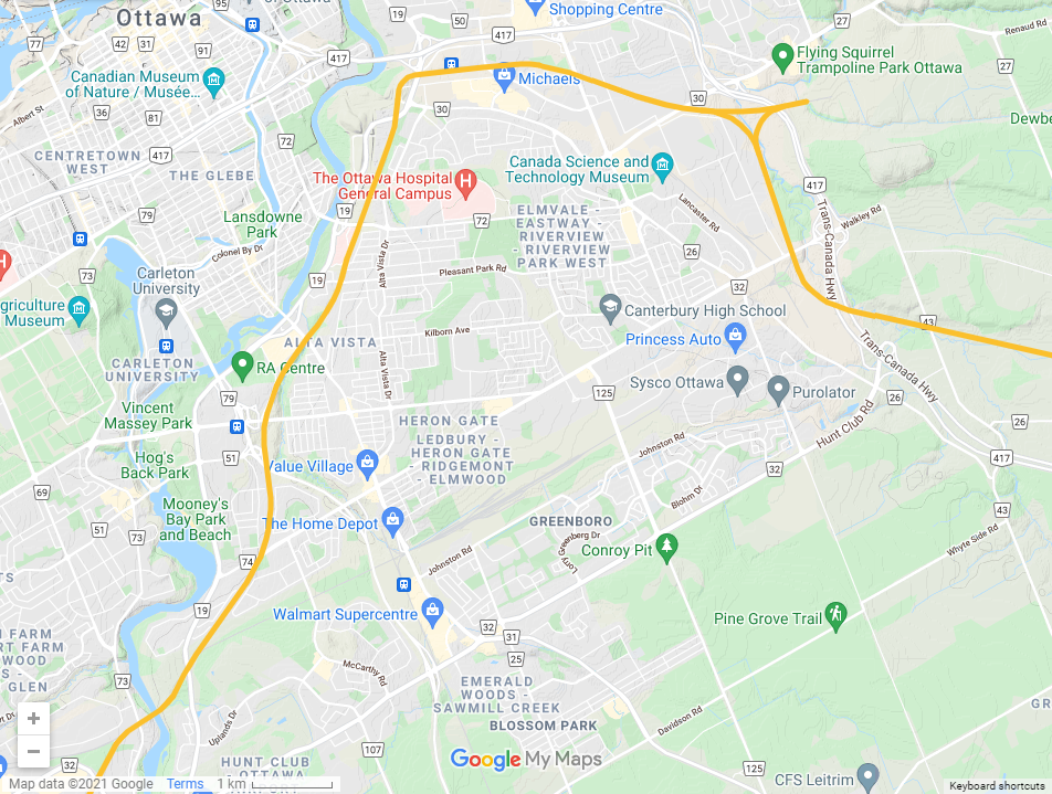

While it is true that VIA could run the express trains through Ottawa on existing track without stopping, the problem is the track geometry isn't conducive for maintaining higher speeds. Straightening curves in urban areas would be expensive and, similar to costs of using a bypass, doing so wouldn't benefit trains that are slowing to a stop in Ottawa anyway. Using the Winchester sub as a bypass only becomes a reasonable option if the costs can be kept to a minimum.
VIA's track in Ottawa
