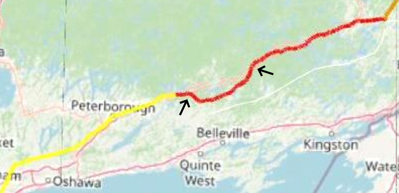

Interesting play. A couple of takeaways. The maps and zooms show they envisage using the don valley route rather than the link through Scarborough. And the map shows 200-300 kph through the existing Havelock-Tay railbed section with no indication of how that could be achieved. Straightening it through earthworks and bridges, or bypassing it to the south, would cost billions. Whose billions?
Yeah this map makes no sense to me. The Toronto to Peterborough segment once outside of the city proper is actually straighter and less curved than the section they are saying they can go 200-300kmh on.
I'd think it would be a combination of level crossings being much more frequent there, and that it would interfere too much with CP. What are the track separation distances like at 300 km/hr - especially between passenger and freight?
