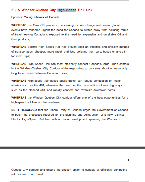

HSR No. 2 on the policy vote result list for the LPC convention.

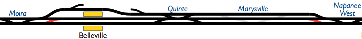

I made a track map of the Kingston Subdivision from Toronto to Brockville (where the VIA Brockville Subdivision splits off towards Ottawa), using satellite imagery.
PDF here as a roll plan:
I discovered that the benefit provided by the triple-tracked segments is limited by the layout of the junctions at either end. For example, at Moira, in order for an eastbound train to switch from the south track to the middle track, it conflicts with westbound trains on the north track.
This conflict could easily be avoided by providing an second, crossover, creating a parallel route through the junction:
My proposed changes (new switches in red), removed switches in light grey:

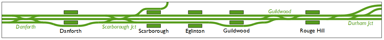

That additional crossover is already present at Guildwood interlocking, but is missing from the rest of the places where the line switches from double track to triple track.

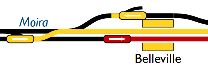

You've got it backwards. The poor punctuality is precisely why we need to reduce this type of unnecessary conflict. If trains all ran on time we could just schedule meets in the middle of the triple track segments and it wouldn't be an issue.
The situation depicted in my diagram is not hypothetical. It is exactly what happened on my last trip to Ottawa. The yellow eastbound train is VIA 48 (Toronto - Ottawa local), the westbound is VIA 69 (Montréal - Toronto express) and the red train is a CN freight that rail traffic control was allowing Via 48 to overtake.
If the trains had been on time, they would have met at the platform at Belleville, and this infrastructure deficiency wouldn't have been an issue. But my train (48) was running late, which meant that train 69 had to sit in Belleville station for several minutes waiting for us to arrive, even though it is not scheduled to stop there.
I have ridden back and forth between Ottawa and Toronto a lot in the past couple months and in my experience, CN rail traffic control is far more friendly to VIA than Metrolinx RTC. If this had been in Mx territory and the CN train had instead been a GO train, they probably would have just left us stuck behind it all the way to Brockville, even if the centre track was vacant.
The latter is also not hypothetical. That's the reason train 48 was so late in the first place. We were stuck behind a GO train the whole way from Union to Pickering because they couldn't be arsed to change our track assignment onto the totally vacant express track. So our 3 minute late departure from Union turned into a 15+ minute delay by the end of Metrolinx territory.
