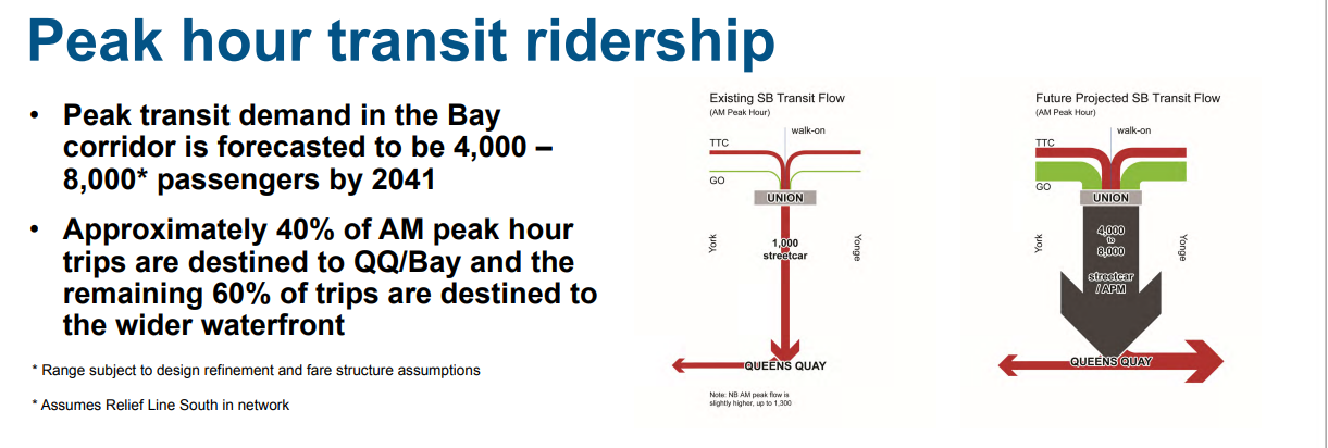

Just skimming through that, and this is very relevant to our discussion here, and the ostensible advantage of QQE doing a surface run up Bay to the Relief Line:
176241
And I include this to show @dowlingm 's point and that of others as to how 'car-centric' this city is. Note the consideration of a 'transitway' doesn't even cross their minds:
