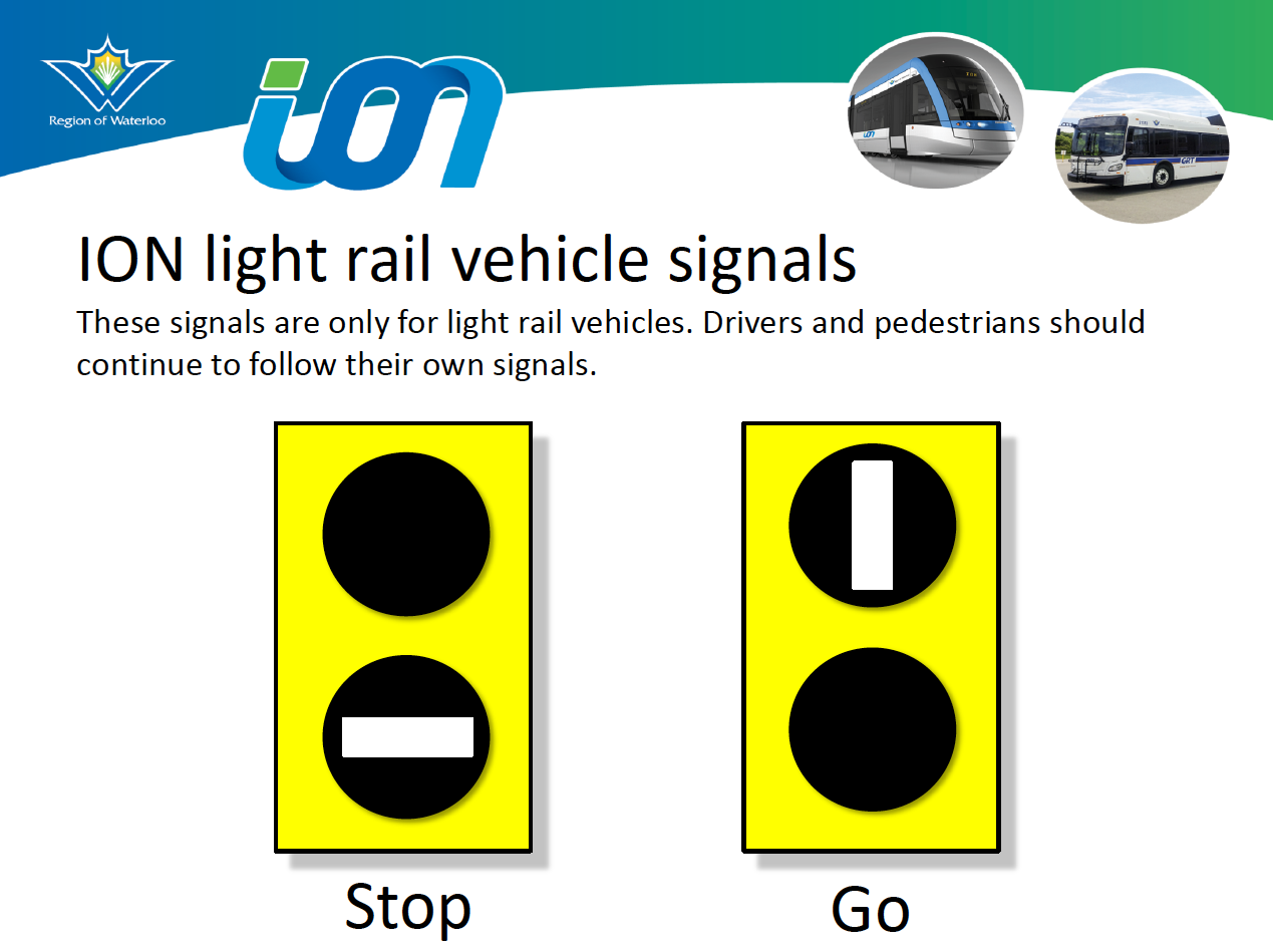

While Waterloo will use international based transit signals:
Toronto's traffic department refuses.
There's more to it than that. It's Provincial, since only one of those signals is attributed under the HTA, and the TTC already uses if in a different way.
@KevinT @reaperexpress would have more details.
Don't get me wrong, the King Street Project could certainly use those and more, but the story is a bit more complex than it seems.
I've also seen a similar light for Viva buses turning left from Hwy 7 to Keele before the latest rapidway section opened.
Those are still provincially illegal signals aren't they? IIRC, Ion received a special exemption for a trial.
Oddly, you're half right! The HTA only sanctions the *vertical white bar"...not the horizontal. I wish it were otherwise. And yes, K/W must have got a provincial exemption or waiver, I've searched many times, can't find it, but they also have Transport Canada waiver(s) due to being connected to a Class 1 track spur.

The reason Waterloo's signals HTA non-compliant has nothing to do with the white vertical bar. As @steveintoronto has noted, the use of the white bar indication conforms to the current HTA definition ("transit vehicles have the right of way when travelling left, straight or right"). In this case, ION appears to have adopted a more restrictive definition of "straight along the tracks only" to allow parallel movements to move simultaneously.
The HTA violations of the signals are rather to do with the lack of green, amber and red, as well as the placement at intersections:
HTA Regulation 626
1. (1) Every traffic control signal shall consist of one circular amber and one circular red indication in combination with,
(a) a circular green indication;
(b) a circular green indication and one or more green arrow indications;
(c) a circular green indication, one or more green arrow indications and one or more amber arrow indications; or
(d) one or more green arrow indications. R.R.O. 1990, Reg. 626, s. 1 (1).
(4) Every traffic control signal system that is installed shall have at least two traffic control signals located on the far side of the intersection from which vehicles are approaching, at least one of which shall be located on the far right side. R.R.O. 1990, Reg. 626, s. 1 (4).

@KevinT and @reaperexpress or anyone else availed of the details:
Is the ION 'light changing priority' an over-ride no matter where the approaching signals are in their cycle, or is it a 'cycle extension' priority?
That could/would be a major difference of the King Pilot v the ION model.

I noted this time the vertical and horizontal white bars in a flashing phase. Is that just an impending change alert, or something more?
