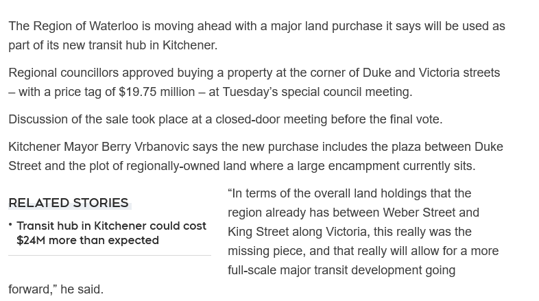

In other news: https://kitchener.ctvnews.ca/the-mi...llion-land-deal-for-new-transit-hub-1.6758684
From the above:
Region doesn't yet have all the ducks lined up to get shovels in the ground on this, but at least there is progress.
From the above:
The Region already owns everything that they needed for the transit hub to go ahead, the platforms as well as the transit hub is on land the Region previously owned between King and Duke. Everything for the transit hub was self contained to that site.
Phase 1 which includes the bus infrastructure, station platforms as well as various other pieces of infrastructure and Phase 2 is the actual transit hub. Both of those phases can occur on those previously owned lands. The most likely reason they ended up purchasing these new lands was because of the legal fallout from the encampment at Weber/Victoria, the Region was planning on using that site for staging and an off site parking lot, but due to the court ruling they cannot evict those at the encampment. The Region is likely planning for the new Duke/Victoria property to be for the staging/parking lot.

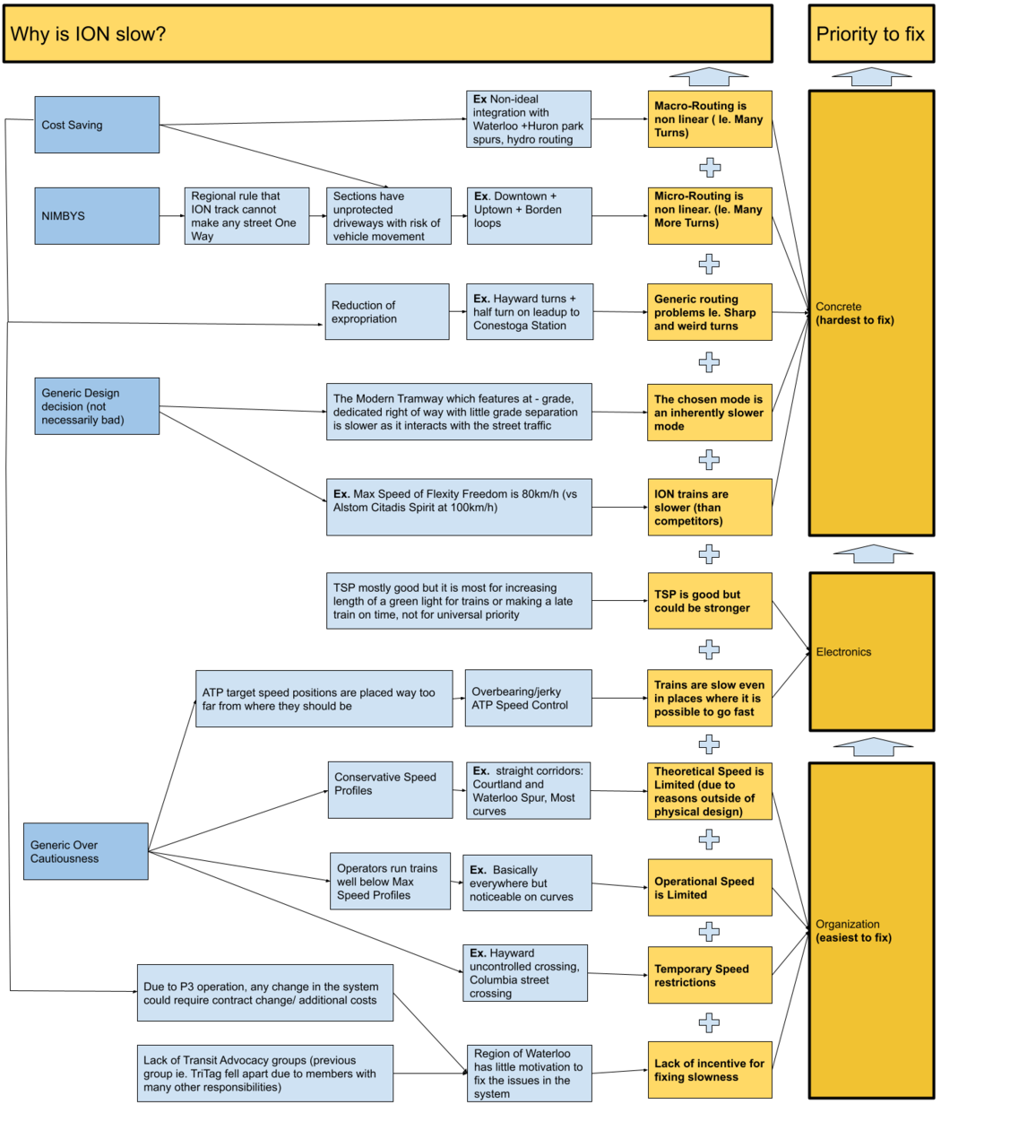

There does seem to be some signaling glitches with the ATP - we should be able to hit 70 on the Waterloo Spur. Places with an up arrow or down arrow seem to be the places where the ATP kicks in. I was talking to a signaling engineer (who did not work on this project) and they think that the ATP speed blocks are incorrectly placed (too far behind stations) so there is improper control.
Getting clarity about this issue will definitely be a priority of Tritag in the future
Linking the flowchart for reference
I have been working on a technical document outlining the reasons why ion is slow (snippet below) (note this is non-official)View attachment 523335
