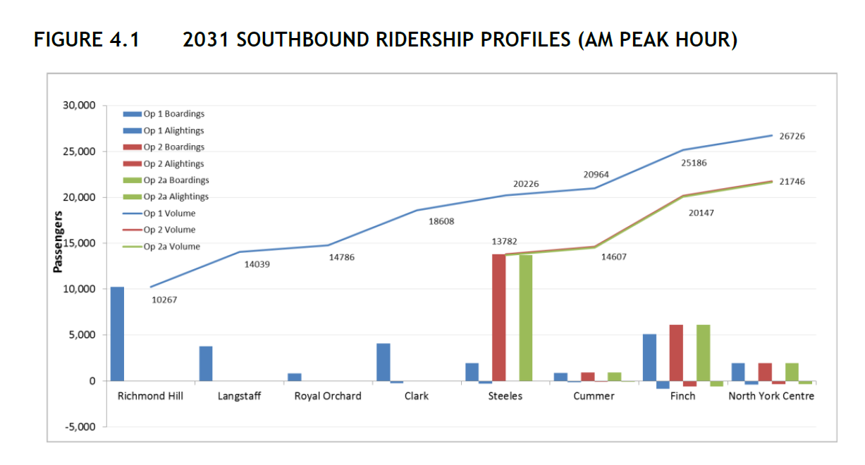

Something nobody wants to admit is that the Yonge line cannot handle riders from York Region coming in.
There is adequate capacity on the Yonge line to serve a 2km radius around each station. Once the RL-North is built, the Yonge line will not have to deal with people coming from beyond that 2km radius in the east as they will transfer onto the RL-North.
The problem is the 15,000pphd that arrive at Finch Station from destinations to the north each morning.
That 15,000pphd is a low-ball estimate too, considering whats planned in York Region and the impacts of a Yonge North subway to Richmond Hill.
