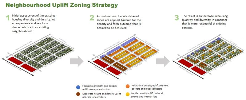

My former hometown has been making some moves on changing the zoning in what would be considered "stable neighbourhoods" or yellowbelt areas here in Toronto. It's slow and steady, but some interesting ideas.
They are focusing with a plan to upzone swaths of Westboro, which is facing significant development pressure due to proximity to downtown, transit, and simply being a livable urban neighbourhood.
The following image was posted to Linkedin by the City's Zoning Program Manager David Wise. I could not locate it anywhere else for citation purposes:
I think that this image presents the evolution of the earlier findings reported here:
https://documents.ottawa.ca/sites/documents/files/westboro_proposedzoning_en.pdf
Depending on how well things go in Westboro, this may be incorporated into other areas by way of an upcoming city-wide review of zoning in Ottawa.
I would love to see similar (or more ambitious) rezoning proposed in yellowbelt areas in Toronto. Upzoning along avenues (in Ottawa, similar roads are called main streets), a more moderate upzoning along collectors and in transition zones behind avenues, and a yet smaller upzoning to allow triplexes, etc. at corners in neighbourhoods and local collectors. I would also love to see more permissive zoning in terms of use in neighbourhoods, permitting commercial use in some of the upzoned locations.

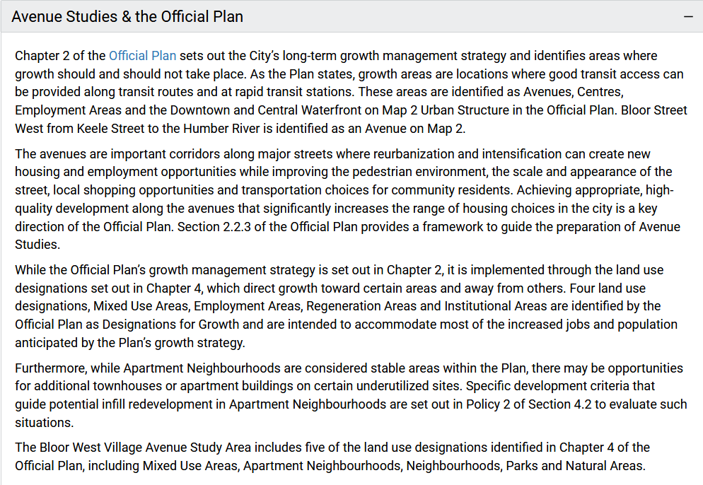

I have a question: why is the city's "Avenues" designation sold short? I mean, why didn't they fully designate all major roads as such? It seems arbitrary and based on various local "concerns" (I can't take a lot of people seriously, including myself ;) ).
Just one example is my section of King Street in Parkdale. I'm talking especially Dufferin-Jameson. It isn't desiganted as an "Avenue" but if you look at even just the current built form....
I'm kinda moaning because I reckon it needs more retail.
Anyway, if anyone could elucidate us on the reasons for the Avenues plan being so apparently deficient, I'd appreciate it, kthxbye! :D

This is the 'official' explanation. I took it from the Avenue study for Bloor West Village; hence the geographical references:
Yeah, so that second paragraph beautifully illustrates my point about the whole plan being a sham with arbitrary cut offs.
And my section of King Street (I don't own it, by "my" I mean I live here! :p ) is still a perfect example of this.
