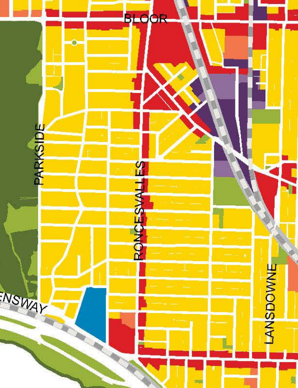

The highlighted area reflects portions of Major streets currently designated 'Neighbourhoods'
Can anyone explain why the west side of Roncesvalles isn't highlighted? It is for sure "neighbourhoods" in the official plan:
Is it because Roncesvalles is considered an Avenue? And if so, does that mean that six-storey apartment buildings already permitted as-of-right on the west side?

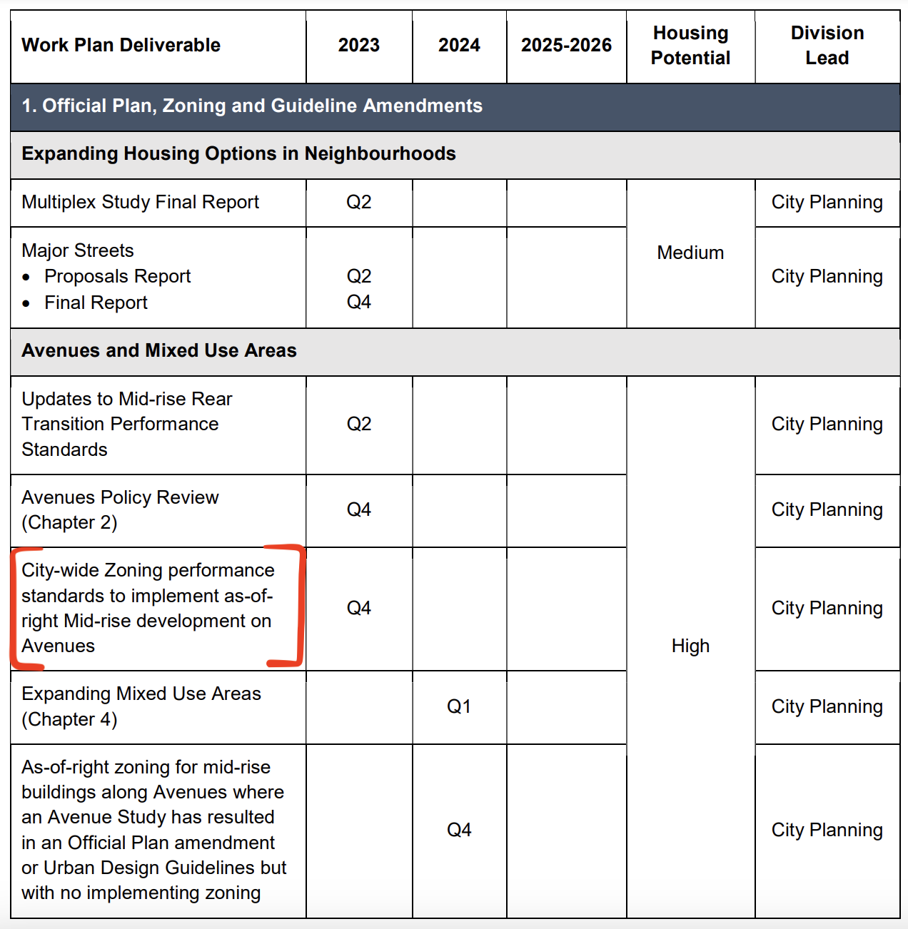

OK, I think I've answered my own question. It sounds like a report on as-of-right midrise zoning on Avenues is coming soon: https://www.toronto.ca/legdocs/mmis/2023/ex/bgrd/backgroundfile-234817.pdf
I do find it a little strange that the city is contemplating as-of-right midrise zoning on non-Avenue major streets first. The Avenues feel like an obvious starting point and I wonder why the city isn't doing them first.
