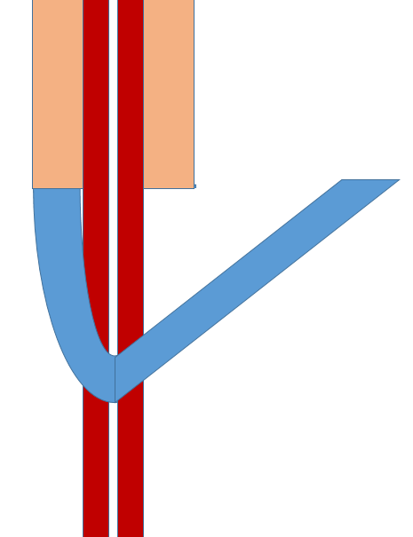

What would break the bank isn't the tunnel, it would be a station that can support game day crowds. Underground stations for even small numbers of people are an order of magnitude more expensive than at grade.
A station that might work with a tunnel would be it popping up for just the station to ground level. Northbound has level access, and southbound has large ramps (blue) over the tracks then to the platform.

Would it be any costlier than the Westbrook Station or any of the Greenline stations?
No, but one of the many reasons the Greenline is truncated is the switch to underground stations - they cost a lot. Just a tunnel isn't so bad - all the associated infrastructure increases costs. Hence on the West LRT where a trench was way more affordable than a tunnel, when the tunnel wouldn't have had a much higher cost at first glance, just putting on a roof. But after a certain distance of tunnel, you need emergency exists, refuges, ventilation etc. Hence the Barcelona method of shaft and in-tunnel stations as an innovation to keep costs lower being explored.
A station that needs surge capacity will cost more. And your costs for underground infrastructure increase at a much higher rate, because you are working in 3 dimensions for all your costs. Double the length or width of an above ground station, you double the cost. Double the length or width of an underground station you square your cost at minimum (not even accounting for things like roof trusses also increasing in cost by the square law, because a beam to cover 10m carries way more weight over a longer distance that a beam covering 5 m).
