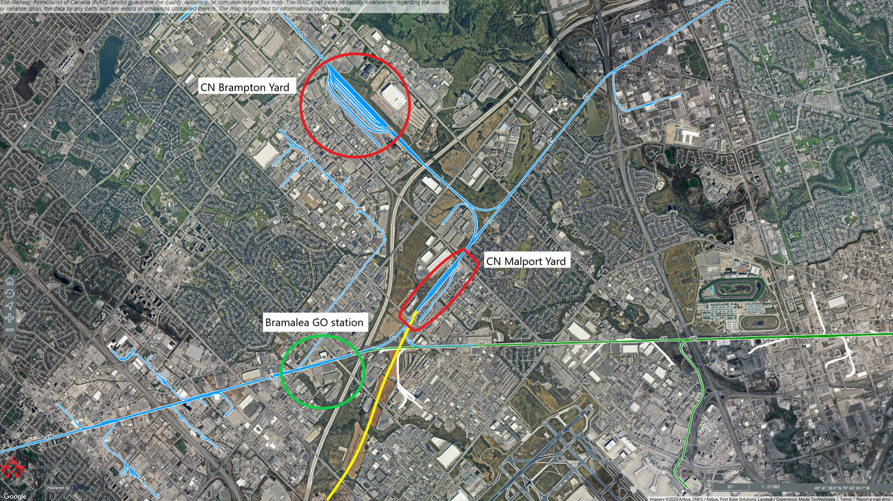

Here's the issue with allowing both CN and CPKC to share the missing link. CN will be asked to allow CPKC trains to run right through the middle of their intermodal operation.
The yellow line represents "The Missing Link". CPKC trains will run right in between CN's Brampton Yard and Malport Yard.
Overlooking the Malport Yard from the Airport Rd. bridge going over the CN mainline.
I wasn't suggesting the additional tracks for CPKC would literally need to go through BIT. They could stay on the south side of the York Sub including the south side of Malport. Lots of bridges would be needed for CPKC to access the MacTier Sub. Options in blue and yellow. Green = CN; Red = CPKC.

There's no room to lay down track south of Malport. The Maksteel plant is located directly south of Malport. Whenever I'm working at Malport the Maksteel workers will come outside for their smoke break and watch us off-load and load up the trains.
Your photos shows a hypothetical junction beside Islington where the CP and CN mainlines meet. I'm sure a setup like that would work, but the problem area is the stretch of track between Torbram and Goreway Dr., which you're not addressing.
Also something to consider is that Goreway Dr. is currently being grade separated from the track via a bridge. The space underneath the bridge is only being constructed wide enough for CN tracks. In hindsight we probably should have constructed an underpass for Goreway instead of a bridge. It would have made it easer to build parallel running CP tracks.
^ I'll address it by saying they'll have to make it work via what's proposed in the study. Since Halwest would need a rail-under-rail grade separation anyways, maybe they'd continue it through Malport via a trentch/cut and cover, and the trucking portion of Malport could be on top. Lots of maps were made and discussed here during the height of the bypass talk in from 2016 to 2019 when the Kitchener Line IBC came out.
