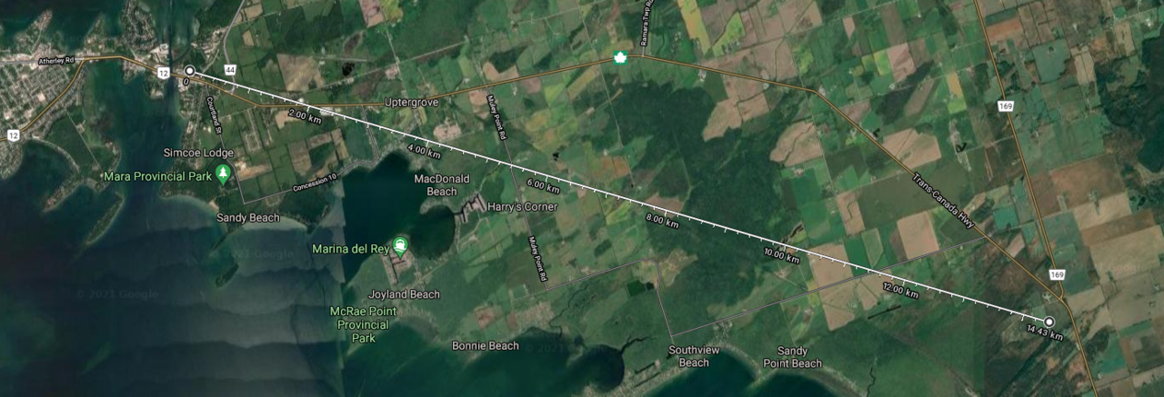

2) Something like this?
That would be one of the options. Barrie to Orillia: using the CP line is a possibility.
Orillia to Washago: I just don't know if the rail through Orillia still can be reclaimed. If yes, then surely that's a better broute, serving downtown Orillia and then using the existing Bala sub corridor. If needed, can add the second track there up to just north of Washago, where the two lines split.
