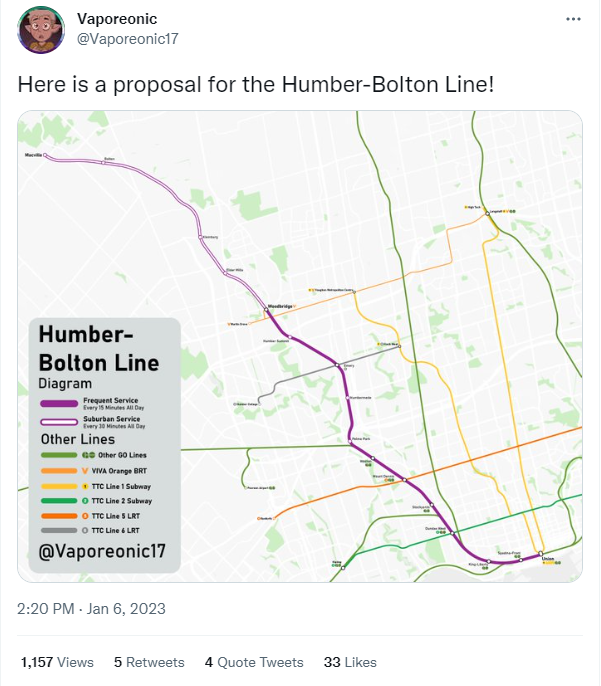

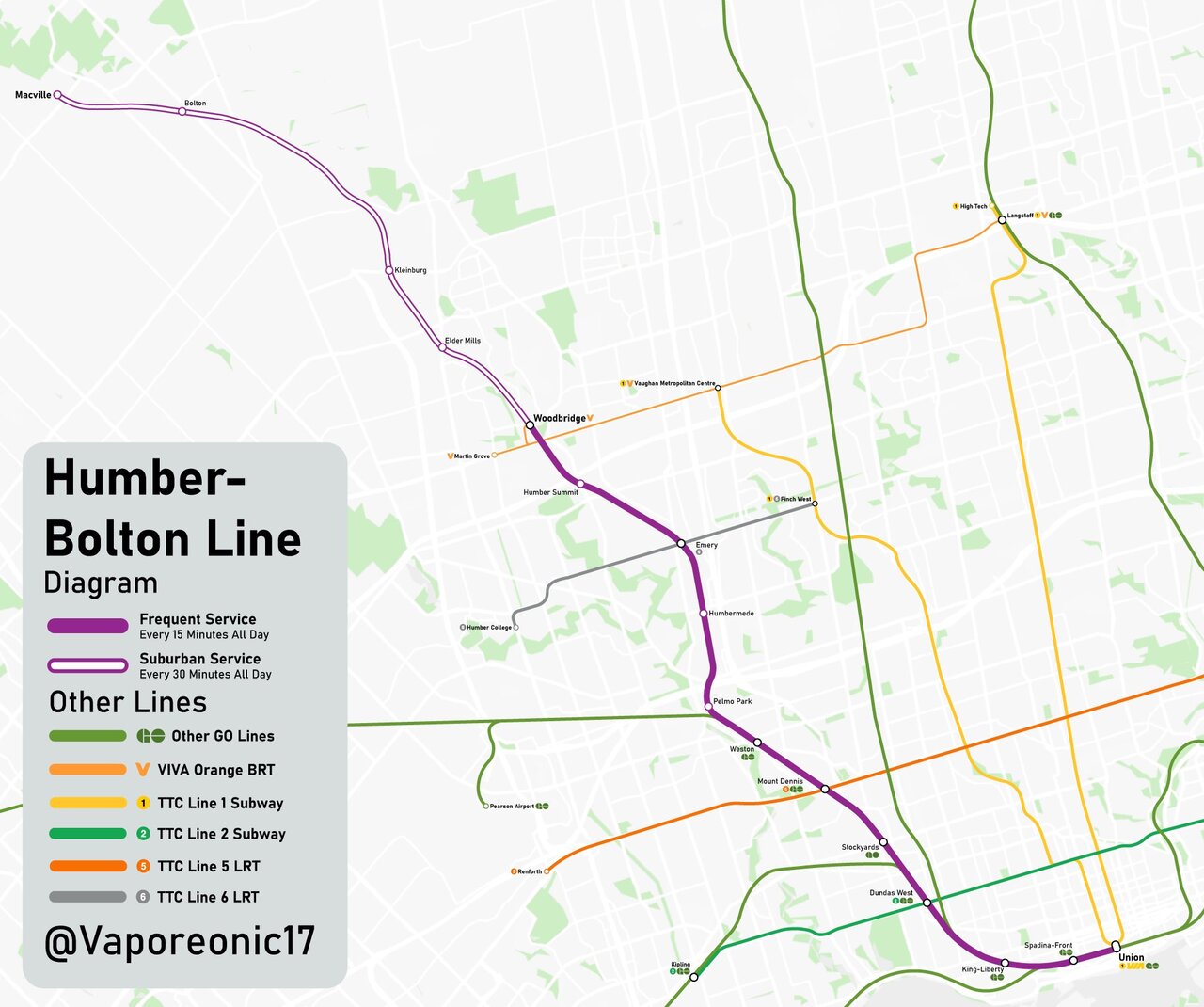

I wonder what the good people of Weston would say about the proposal to run a GO train - diesel most likely - running by every 7.5 minutes on the surface beside the tunnel that was built to avoid having a GO train or UP Express train (It was Blue 24 back then) running by on the surface every 7.5 minutes.
I suppose it's possible to create a branch off the Kitchener Line at the north end of the Weston Flyunder so that Bolton GO trains would not have to run on the surface through Weston. The cost would be substantial.
That new connection might necessitate a grade separation at Oak Street, I'm not sure how the elevation works through there. The Kitchener line is already climbing westwards so the gradient required would not be as many feet of height as the full tunnel. But it would really mess up traffic patterns on the Kitchener line. if trains had to cross over there
North of Steeles on the Bolton line there is a 2.2km stretch in which there are five single-track bridges. Doubling that segment would be very pricey.
All of those costs, plus the absurdity of running 15-minute headways on the surface next to a 4-track tunnel that was built to avoid that disruption, plus the lack of density (so far) towards Bolton, makes me think that a 15-minute RER service is fanciful. More likely just Richmond Hill-quality commuter service to start, and perhaps hourly 2WAD eventually. Even that may be fanciful - ML likely is reevaluating its ridership modelling in light of continued WFH changes. I'm not sure that even peak loads are all that compelling post-covid. The cost per rider will be quite high.
But hey, there's plenty of Greenbelt and farmland up that way, so development will happen - so long as Doug is with us, anyways.

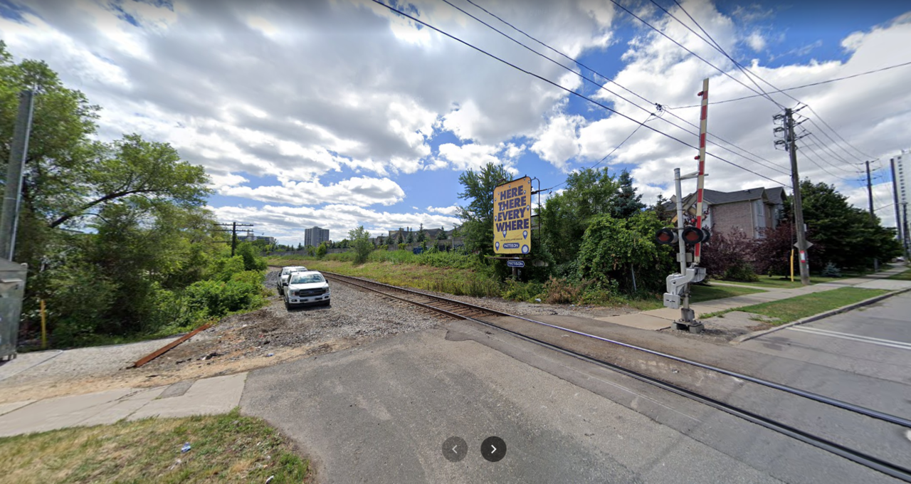

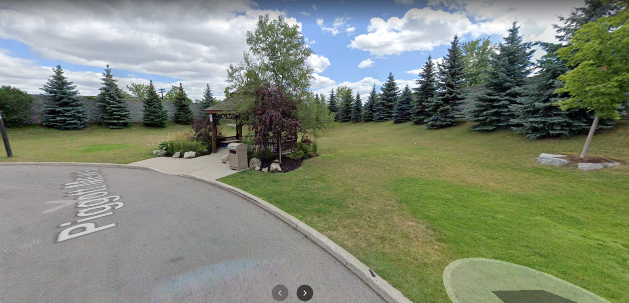

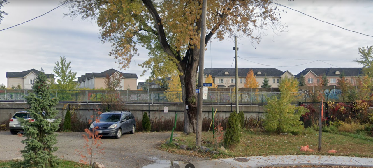

A look at elevations for Paul
Visually first:
Below is Piggott Mews, at the top of the image (straight'ish) is MacTier, on the right is K-W)

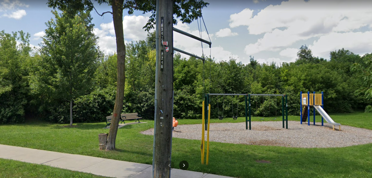

Parke Street is the opposite side of the K-W corridor:
Now we're back on the north/east side, and looking MacTier from further south (Queenslea)

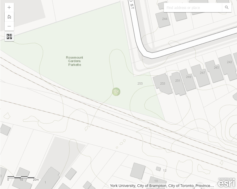

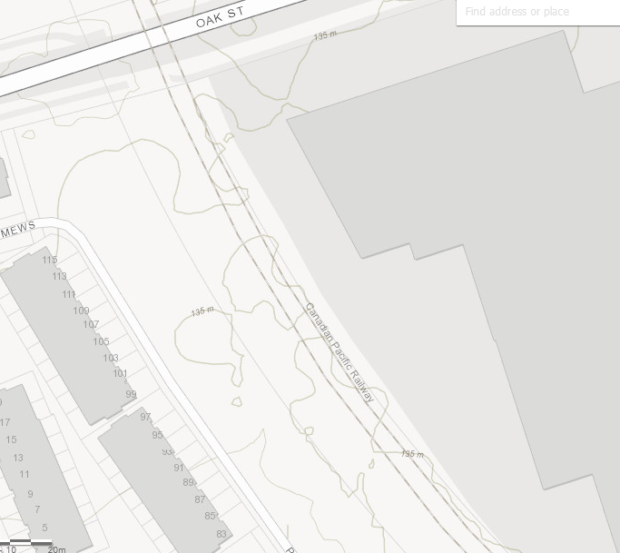

Now the overhead view, with contour lines (elevation change between any 2 lines is equal to 1M )

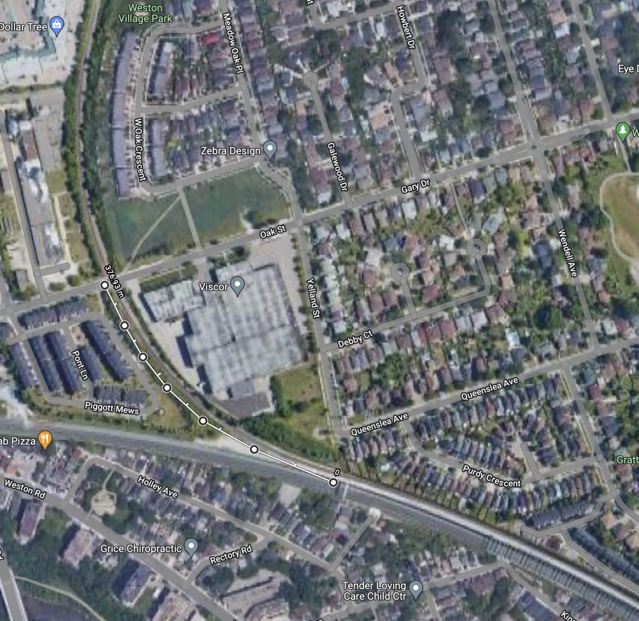

Lets look further on to Oak Street:
Big ROW at Oak Street for MacTier: (looking south)
Your distance btw Oak Street and the K-W corridor is just a smidge over 300M

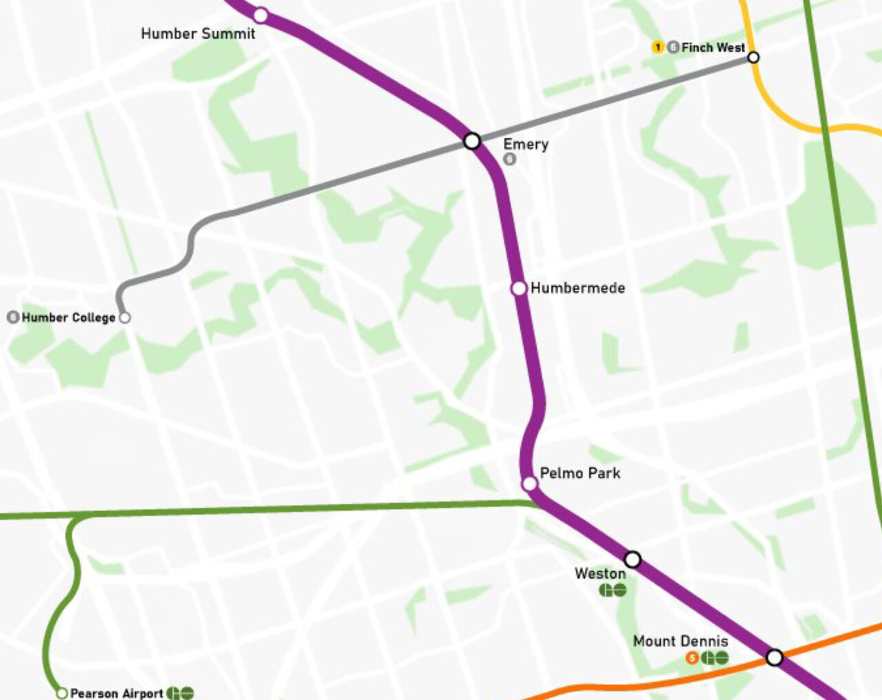

If the platform layout at Weston is as Wikipedia shows it (a diagram by @reaperexpress I believe?) then the easternmost platform will, like the one at Mount Dennis below, back onto the CP alignment, forming a de facto fifth track through both stations should Metrolinx obtain permission to bring their structure as far as the boundary/structure gauge of where a second CP track would lie.
If the track is doubled then the CP would take the eastern of the pair exclusively, and GO have use of the western. The question would be whether CP interconnect track arrangement still works on that basis, perhaps with a movement onto the GO-CP preceding a move onto the GO, and additional bridging over Black Creek on either the Metrolinx side or the CP.
The Pelmo Park station is at Wilson, and Humbermede at Sheppard - given the local density I don’t know if even one station works there, let alone two?
