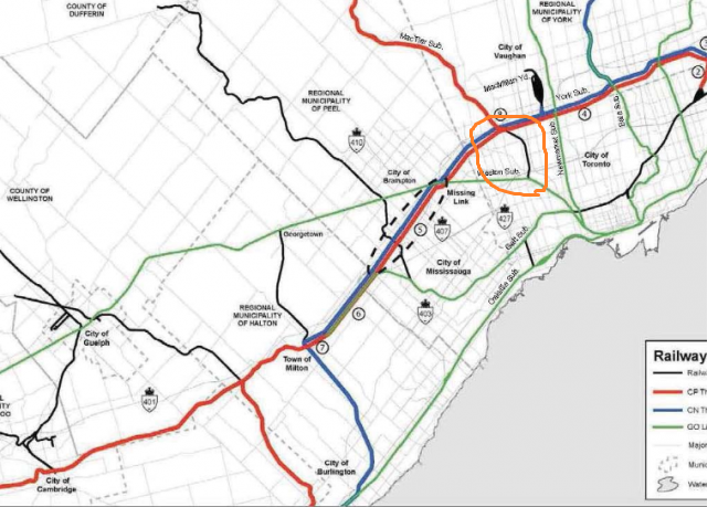

Here's the Weston-ite perspective. If they were to contemplate a frequent service along a second tack on the CP corridor, I think it would have to be grade separated. That would mean slotting it into the 4 tracks of the existing tunnel (with the necessary grade change, and with the scheduling complications of cutting into the 2xUP, 2xKitchener tracks within the tunnel).
Going into the Weston tunnel from the north, this would likely necessitate a grade separated crossing at Oak St.
Coming out of the tunnel into Weston station, it could theoretically move to the outside of the new Weston 3rd platform, as there is space over there, then follow the CP overpasses over Dennison (new one pre-built to accommodate 4 tracks), etc. Maybe it could terminate at Weston, but likely Eglinton for the connections, if it wasn't interspaced into the Kitchener traffic right to Union.
I do not think that a station at Pelmo would happen, unless Smart Centres offered to build one in its redevelopment of Crossroads Centre.
As for power, you could potentially do hybrid locos on this run, switching to catenary if it files into the existing Kitchener corridor at Weston.

Btw just wanted to comment that full electrification and using RER style EMU trains at least to Humber Summit would be possible if the full Missing Link was built.
You'd then need a separate express service with diesel (or bi mode) operating past that. But that would make sense to do anyways with these service patterns.
