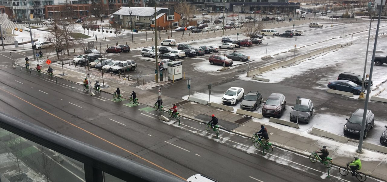

East Village and 12 Avenue projects make up bulk of work in downtown core
