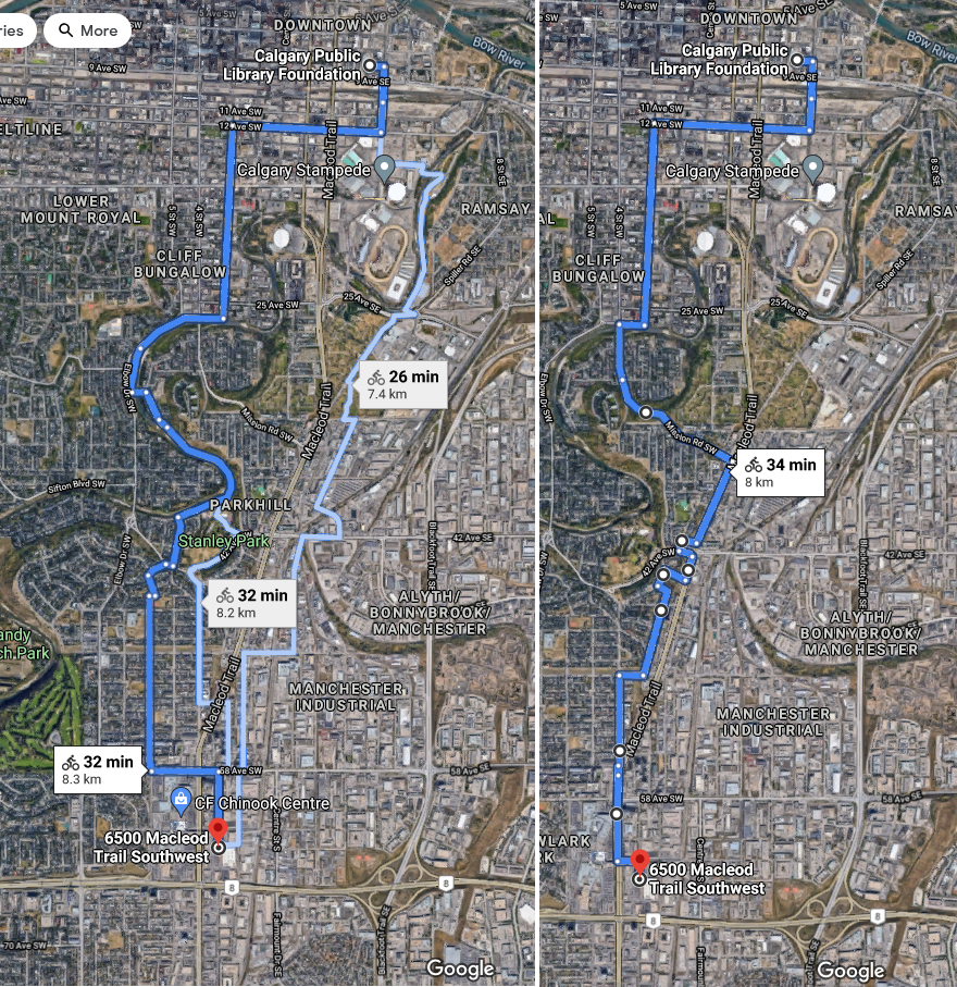

I think it's a little unfair that cyclists would be expected to travel 8.5 km to make a 6 km trip to maximize use of better infrastructure. I put the trip into Google, and it's suggested shortest cycle trip (7.5 km) would have gone around the Stampede, then on Spiller, Manchester and a bunch of other crummy industrial roads east of Macleod. In fact, his chosen route actually increased the use of high quality pathway and cycle track infrastructure.
The alternate path that Google suggested with increased use of the pathway (8.5 km) went down the Elbow to Stanley Park, then mostly down 5th St. The route he took (8.1 km, with a couple of weird zig-zags) only had 5 blocks on Macleod, then a bunch on side streets that are no better or worse than the alternative of 5th St would have been. Macleod is a major corridor with a lot of businesses along it (there are many similar roads in other parts of the city; 16th Ave, 32nd Ave, etc.) and I think it's instructive to show what cycling infrastructure is or isn't available.

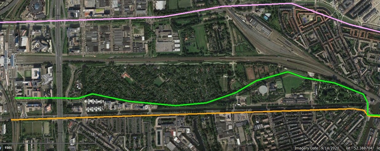

Literally the sentence before the one you quote notes that this pathway is through a park, but it is not just a recreational path, "it is well connected and actually takes you where you want to go". He is taking a path that happens to go through a park, but it's straight and offers the same connectivity as a car would have. Here's the path he's taking at this point of the video (starting lower right); his cycle path is in green, the orange is a parallel road less than 100m away, and the pink is a higher capacity parallel road about 800m away. He's taking the cycling path but it's essentially no further than he would have gone otherwise, and it's probably shorter than the route he would take in a car. (PS: both the parallel roads highlighted have wide, separated cycle paths.)

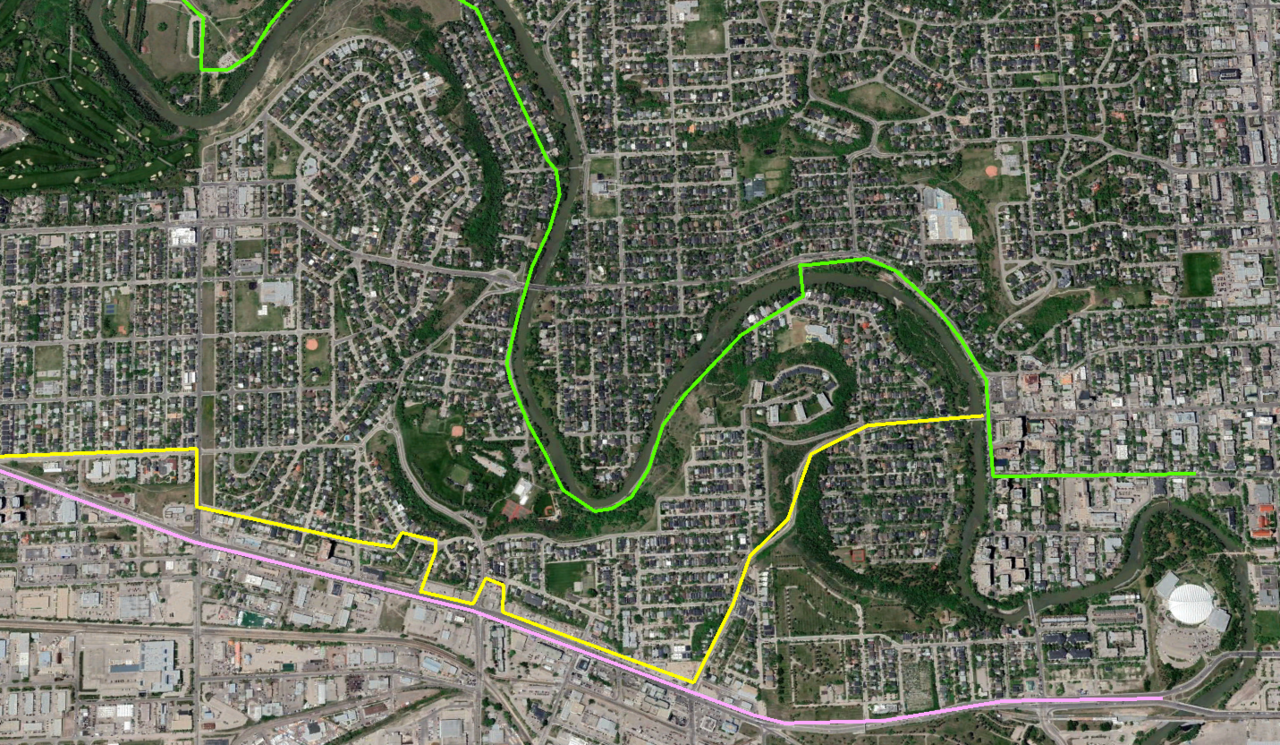

This is the situation along Macleod, same scale, the cycle route in green, the high capacity road in pink, bike route from the video in yellow.
They're both taking more or less the best available cycling infrastructure that actually goes to the destination, not just taking whatever good cycling infrastructure is vaguely in the same postal code. He's not riding on Memorial and ignoring the pathway running parallel, he's decided to not take a route that meanders (and is a lovely recreational ride!) nowhere near where he wants to go. It's not like the Calgary guy is taking Macleod to go to Sandy Beach park, he's taking Macleod to go to... a business located on Macleod.
Fundamentally, the reason the Calgary guy is taking a route designed for cars is all of our routes are designed for cars.

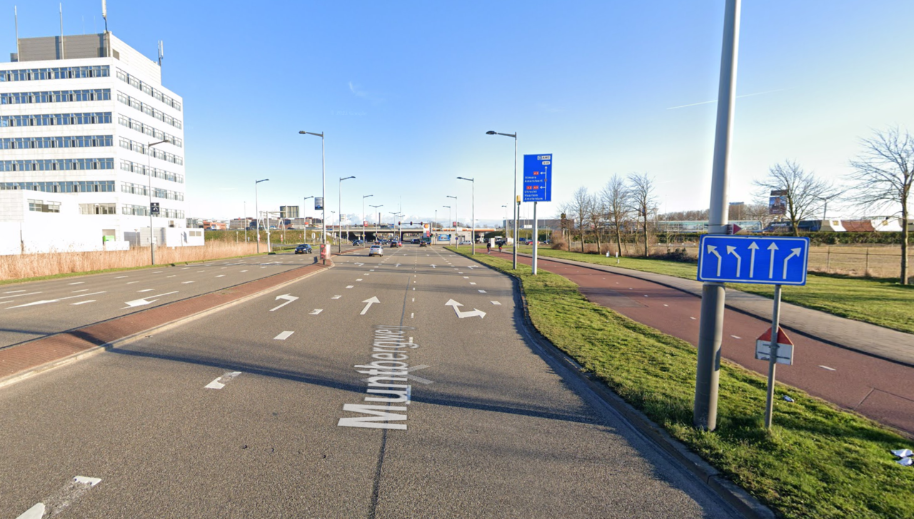

This exactly. To further illustrate the point, I tried to find the most MacLeod Trail-like road in Amsterdam. This a major car-oriented road leading to a highway interchange and an industrial park on the outskirts of Amsterdam. Note the bicycle lane and sidewalk to the right. Remarkably, when they added the right-turn lane they shifted the bicycle lane over without reducing it's width or throwing a sign in the pathway. They even kept a consistent width of the green buffer. This really shouldn't be impressive - but by North American standards it's outstanding.
Second picture is an intersection on the same road. Note the lack of slip lanes, weird pinch points of a randomly changing width of path or sidewalk, and all sorts of curb ramps that a cyclist or pedestrian would have to contend with here.
This pathway quality, width and connectivity is superior to 99% of our pathway network and this is literally in the middle of nowhere industrial park. The paths are straight, wide, barrier free, separated from traffic and actually go to businesses and destinations - exactly how we plan arterial roads in Calgary but for bicycles. Super boring stuff and not an attractive bicycle ride, but will get you to where you want to go safely and efficiently.

What's even the point of nerdy development forum if we don't belabour things. Here's what happens when I force the route to stay on MacLeod:
So if the video cyclist had access to Amsterdam-style arterial bicycle network infrastructure along MacLeod, the trip would be 19% shorter (1.5km off of 8km) and save about 10 minutes each way. Also it would be significantly safer. I think we have invested in billion dollar highways with less trip improvement stats than that.
Does that mean that a MacLeod Trail path is a good idea and would be worth it compared to the hundreds of other pathway improvements we could make ? Who knows - but illustrates the point we don't accept weird detours, dangerous randomness, and 19% longer trips for vehicles very often but totally do for bicycles (and everyone else frankly).

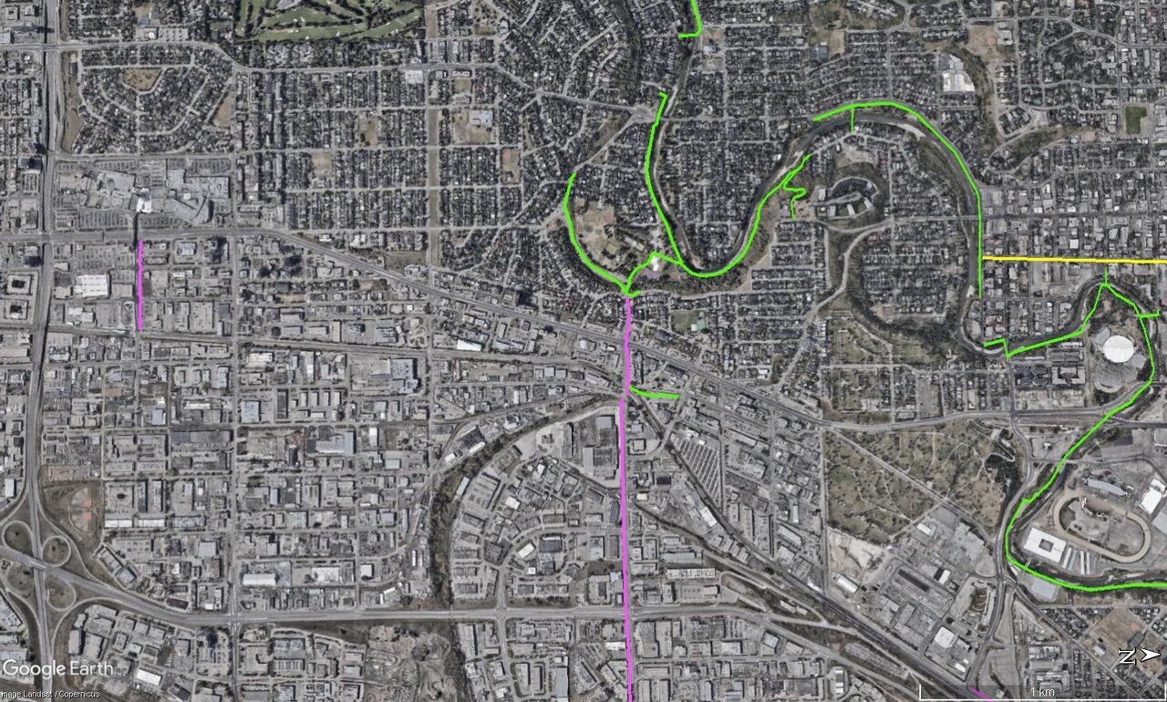

Here's the existing conditions in the corridor --- green are multiuse paths, yellow are cycle tracks, magenta are sidewalk/bike improvements (bike paths alongside sidewalks). There's no connectivity, the recreational paths are lovely but don't provide straight or efficient connectivity.
