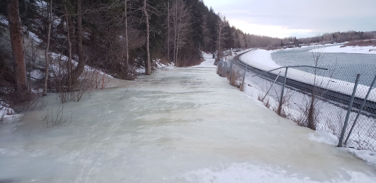

Here is what the ice on that pathway looks like in the winter. You can see it pushing the fence over slowly. It's probably at least 2' thick here
I think in spring it usually becomes more sloped towards the tracks, with a particularly tricky section in the middle.
Tbf it is clearly marked as closed, but perhaps it would be better if they were even more specific with an "Impassable Ice Flow" sign.
Seeing that, it gives me context in how this person got hit by the train since it's narrower than I initially thought. Still shouldn't have happen and was definitely Darwinism, but revitalizes a concern with this section of the pathway system.
If the costs of improving the pathways to be an all year path are too much, then the planned pedestrian bridge over by Parkdale Blvd and 32 St NW could at least help in connecting the south part of the river with the north. The area west of Lawrey Gardens could be downgraded to a natural gravel path, and not a paved pathway anymore.
That's from mid winter a couple years back, now it's mostly clear with only ice right where the water runs down the slope above. The pathway is closed in winter exactly for this reason, it's just super easy to go around the gate.
I think the sign says "seasonal closure due to ice" but I haven't looked at it in quite a while.
That's a nightmare spot to ride through especially in my road-only bike; narrow, busy and the pavement is disintegrating in big chunks. Having seen the winter glacier, it's obvious why.
