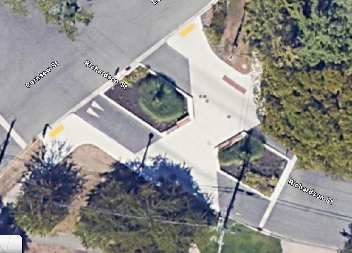

IMO 15th and 14th should have been managed with speed humps, diverters, and daylighting.
They are inherently slow and quiet streets already. Create the expectation that a motorist should never even have the opportunity to pass a bike on here, because a motorist should never even drive more than 2 consecutive blocks.
They did this successfully in Victoria and it radically reduced car traffic on the street. Local access for cars was unaffected. On Vancouver St and Richardson St they deadended the street for cars and replaced it with a small plaza of sorts in the middle of the street complete with sidewalks and bike lanes for through access. This is perfect for those quiet Beltline streets.
View attachment 677120View attachment 677118
The city did something like that in the Balmoral Circus Park redesign and quite a few of the Kensington streets are deadended. Agreed the city should be doing more of these.
The Richardson St. example is more like the Kensington context. The Vancouver St. example is more applicable to how we can change the Beltline for the better. When I think about it, the Beaulieu Gardens park already provides a great example of what could be. 6 Street was shut off between 13 and 14 Avenue. Let's have more of these great urban spaces
