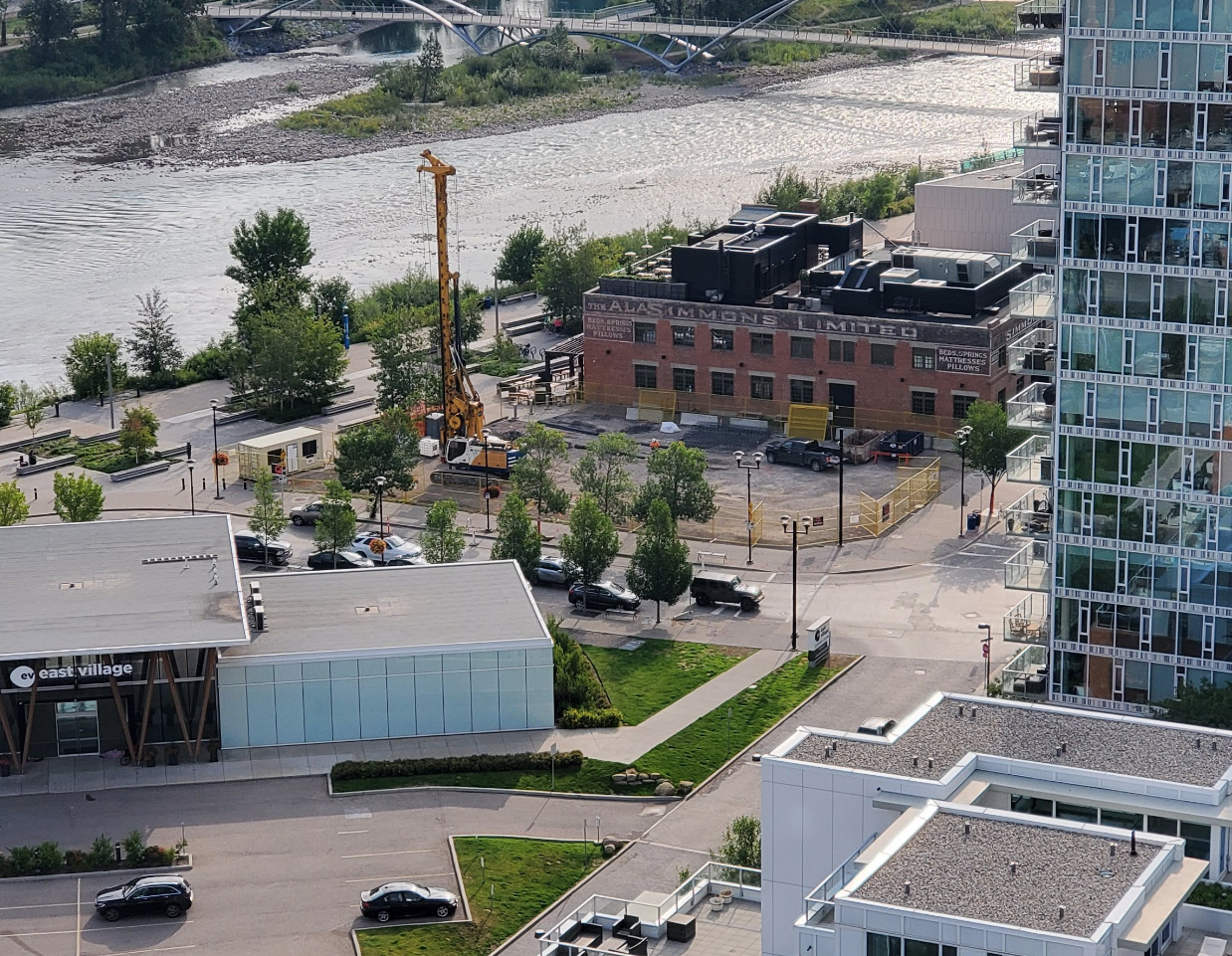

Nothing happening yet, but the gate is wide open. Maybe equipment is arriving today?
They set up some form of pile hole drilling equipment on the site late yesterday. They are also currently tying rebar cages. I'm not familiar with the construction techniques that are going to be employed here, but it doesn't look like there will be any excavation happening, based on this (?).
Which brings up the question .. what about parking for the 44 residential units?
Zero parking for this one. They are likely creating piles to support the ground level slab. This build should go very fast.
