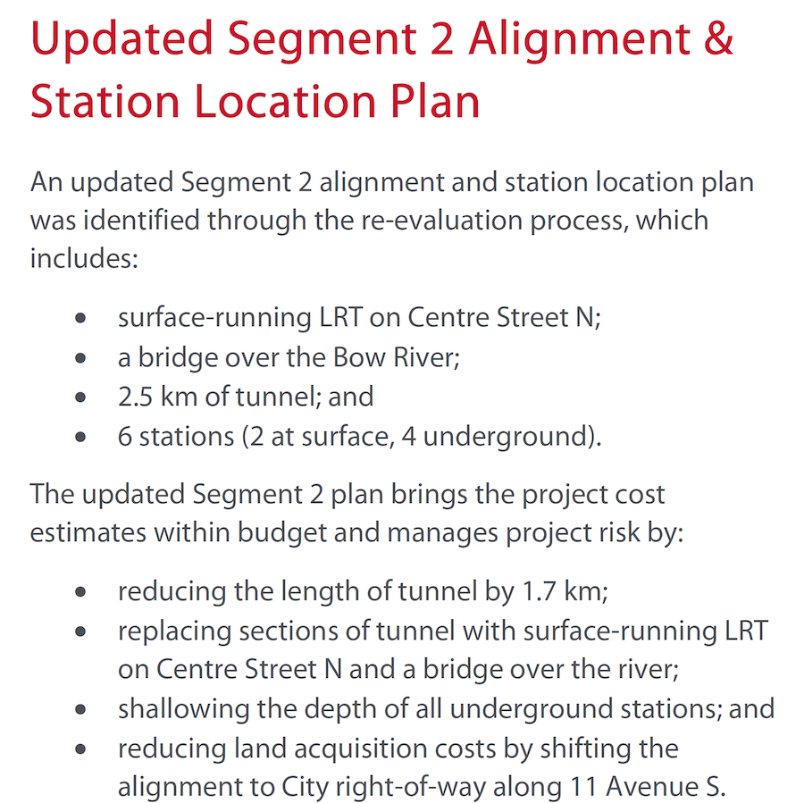

Making cuts in the quality of an alignment because it simply costs too much has already happened before. The Bow to 16th Avenue section was originally tunneled but it became at-grade. The Green Line had no problems making that change then, despite the traffic chaos it would cause to vehicle and bus commuters because it simply couldn't afford it anymore. Why should this part be any different?
