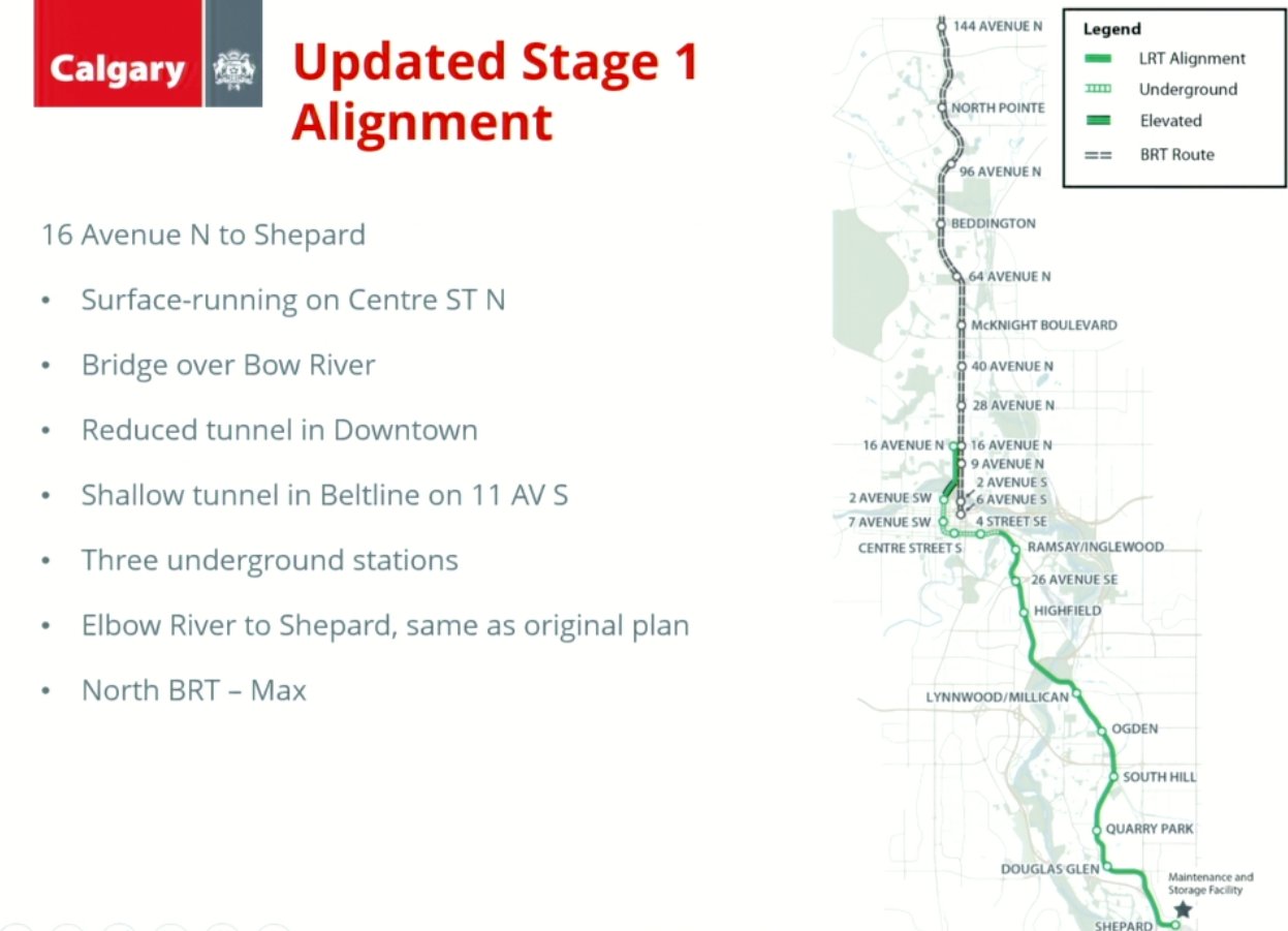

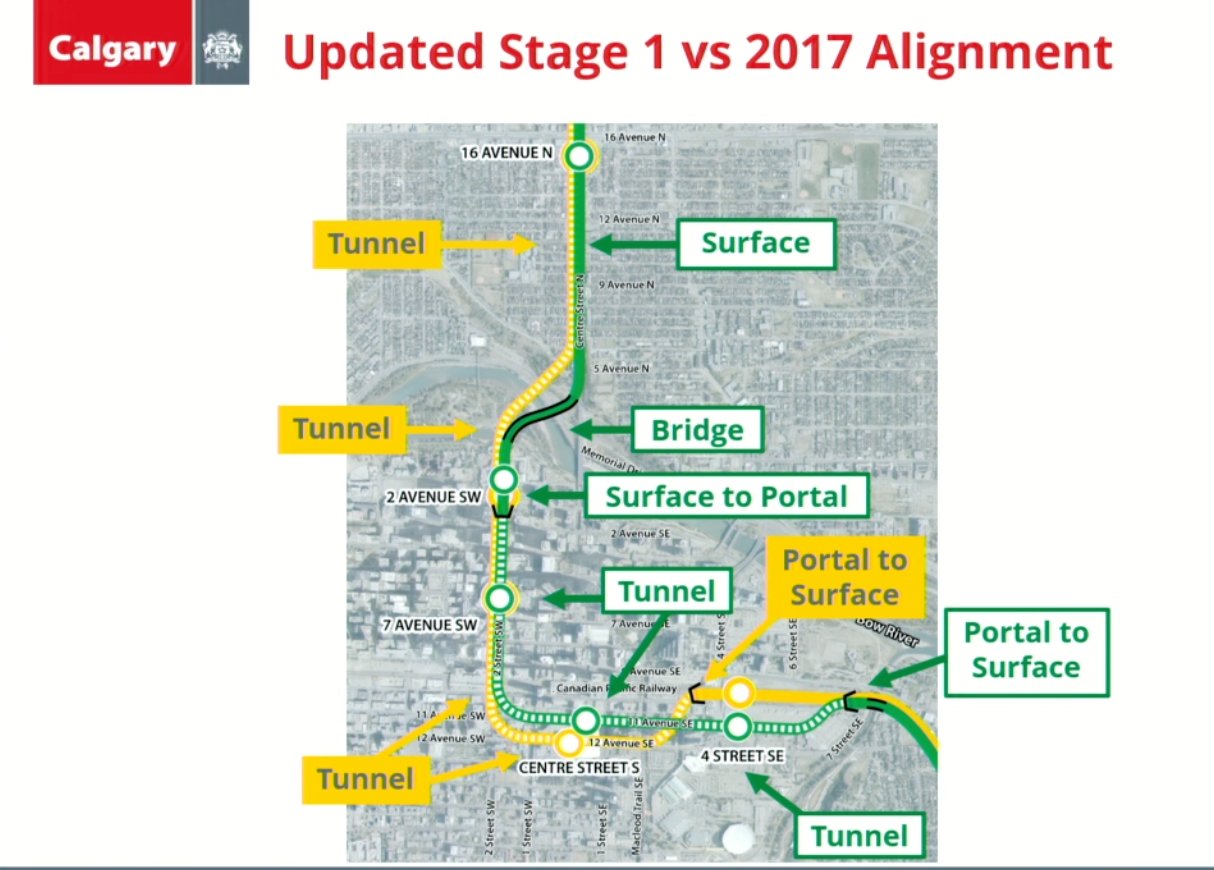

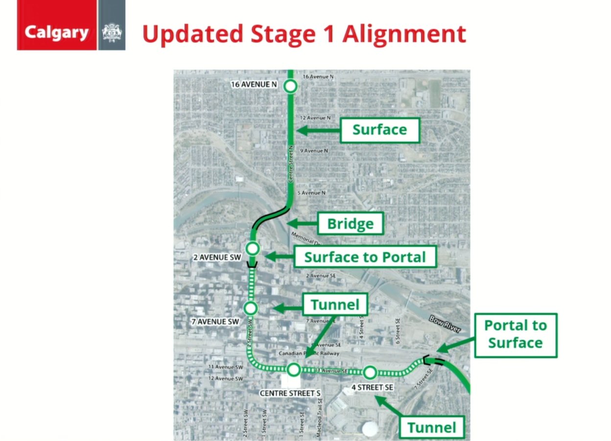

This is being reported as the new proposed downtown alignment
Yeah, with that plan, you hack off crossing the Bow to 16th later, or perhaps with a low enough bid you make it a tunnel again, and you're done. BRT and LRT could share the ROW on centre I guess, but it is going to be a gong show of the highest order.
I could see a world where the surface LRT on Centre St south of 16th Ave is pitches as 'temporary' if the bridge/surface interface left enough room for a future tunnel tie in to get to a future station at 16th.
How are you going to fit LRT tracks on centre street? What about the vehicles traffic? Are they going to be widening Edmonton trail instead?
Does anyone know why they added tunnel in Beltline? The underground 4th St station will be an asset for Events Center users on frigid winter game days for sure, but will reduce some pre & post event foot traffic at street level. The previous alignment would have had Events Center users walking between 12th ave and 10th ave which would have been good for restaurant/retail business in that stretch.
I like the idea of a surface station in Eau Claire anyways. Perhaps, if they're using low floor trains they could integrate it into the neighbourhood like Portland does at their Pioneer Square.
A comment on another site, with the Centre Street BRT continuing to 6th Ave, is wondering why bother bridge over the Bow and up to 16th now for little benefit. It'll get people to use the green line to and from the Events Centre. Otherwise they'd need to walk ten blocks over to Centre and 6th Ave to catch the BRT.
Ooofff, not sure I am happy about this. Might need to sleep on it lol.
The added tunnel length is especially weird in that they moved the 16 Ave N station to surface. Seems like a big mistake to me, though I do appreciate the extended underground length in the Beltline. I hope they can figure out to do both.
LRT traffic crossing 16th ave doesn't seem right to me. I think it'll be a gong show for traffic. On the flip side it might slow down traffic on 16th enough to make it into a half decent avenue.
I wonder what it would cost to do a depression for the line under 16th and back up again? Essentially a narrow underpass.
I wonder if the 16Ave station will be semi dropped like they did for the WLRT...
I'm happy they are tunneling further in the Beltline, makes sense for the event centre and future development in the Rivers District.
